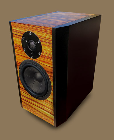

Now here's a monitor that will kill pretty much anything for $3000. Would be cool to compare with the Mundorf MA-30.
http://www.taylorspeakers.com/html/nada.html
https://www.madisoundspeakerstore.c...a-2-way-klang-ton-kit-pair-using-illuminator/
