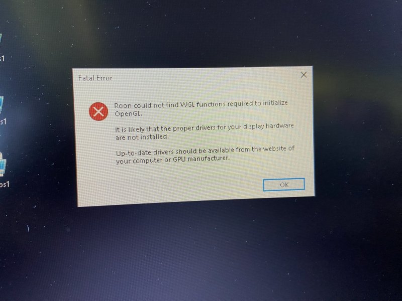

I have no further info on this ATM, but we regard it as a high priority.
Further Roon updates could again cause issues, but not necessarily. It depends on a few circumstances.
I created a document (attached below) describing the issue along with steps to fix it after the fact, as well as a method to follow to prevent this from happening again during a next update. This is a circumvention and not a full solution, but we are working on that.
The steps involved are certainly "doable" for someone familiar with fairly common Windows processes such as Task Manager. But if the descriptions do not make sense, please contact us to carry out the procedure for you.
I followed the steps indicated in the document, until I got to: run the Roon Server Icon on the desktop, then it gave “Fatal Error”. It really is very “fun”
That is “Roon” as in the user interface. The document refers to “Roon server”.
The user interface cannot run without a graphics card supporting a higher level of Open GL which is not in the Extreme. The Extreme makes use of the VGA functionality of the Aspeed 2500 controller used on server boards which is very basic in functionality and only supports up to OpenGL 1.1.
The Roon user interface was never installed on the Extreme before but Roon no longer a separate installer for just the server. So you now get both.

It’s not a big problem, roonserver.exe was just changed due to the overhaul Roon did on their installer. There are alternative ways to implement toggle functionality.
