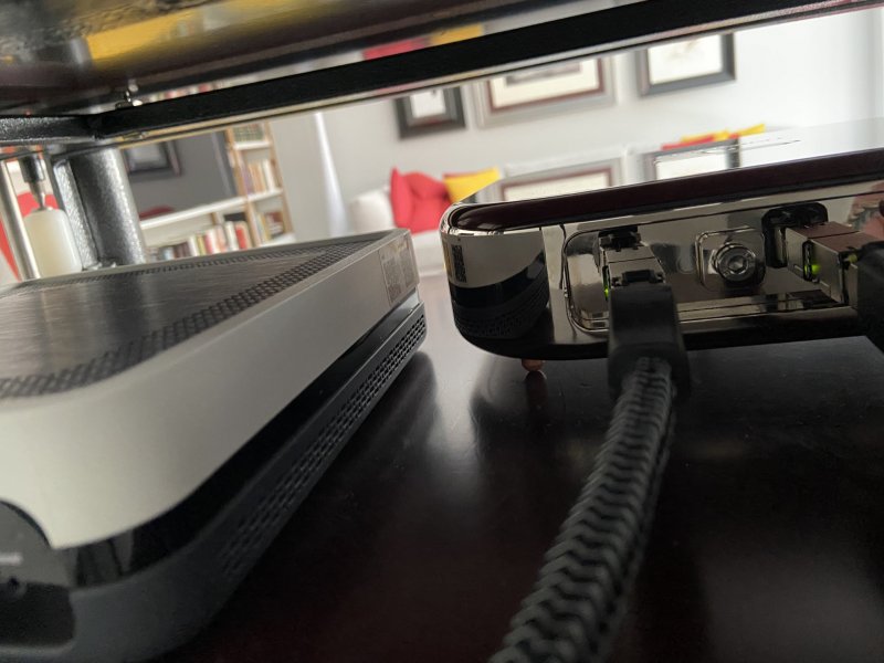

Has anyone managed to fit a spade of one of Shunyata's new ground wires into the Switch's ground screw? If you have succeeded, I would appreciate if you send a picture.
Hi Emile.
Of the two connection possibilities: from below or from above, the first is not possible due to lack of space. From above the problem is that the screw should be further out, since as it currently is, the spade hits the upper projection of the Switch and cannot be placed.

In the red circle, the upper projection with which it collides.

Perhaps for successive chassis, you could make the base where the screw sits about 5mm larger, I think that would solve the problem.

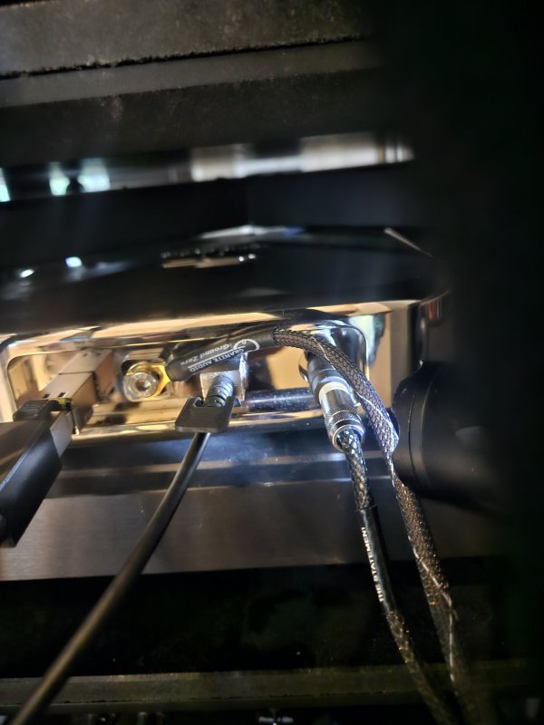

I am using a Granite Audio Ground Zero ground cable which attaches to a Shunyata Everest. Perhaps my spade is slightly larger than the spade
you are trying to attach here. It is a tight fit but I was able to make it work.

My mistake, perhaps my spade is slightly smaller than yours.
I was finally able to insert the spade, loosening the screw a lot, not ideal, but it works.
You probably have the larger (6-8mm) spade from Shunyata. I used the smaller (4-6mm) size and had no issue connecting it to the Switch. Hope this helps. (Can't get a photo because my Switch is "buried" under a bunch of stuff; but trust me ;))
yes my spade is 6-8mm
That's it then. Shunyata can just send you the 4-6mm and you're good. You’re welcome, btw.
