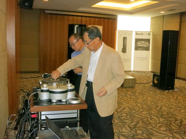

Nishikawa-san, designer of the Air Force ONE, explains some of the intricacies of the design to an enthusiast. I will be with him for the next few hours..... so if anyone in WBF have questions, fire away.
Hi Gary,
What is his opinion of using the AF1 on an active isolation table like a Herz TS-140 as long as you go rigid on the vertical foot support ?
