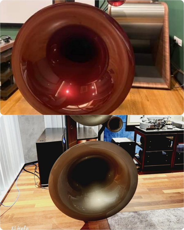

Thank you for taking the time to make this video that clearly explains the key points related to speaker azimuth and rake angel.
Can I ask a few more questions, one about the distance between the tweeters and the other, have you placed the spacehorns behind the Trios in the same position as they are or horizontally to check the differences?
Of course, it is clear that if they are behind the Trios, it will be visually affected, but as Jim Smith said, In terms of sheer musical involvement he always preferred to have basshorns reasonably close to the rear of the Trio horns.
