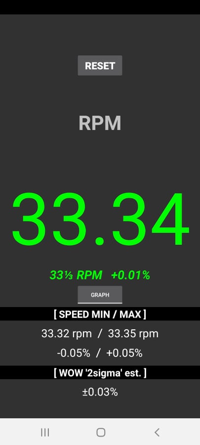

addendum to your question thorens td124Screenshot_2021-12-19-13-24-55-96_35dd66a46e2000e66c3d544dbb2180f8.jpg
the app measures wow and rpm meter, you start it on the turntable and speed is measured.
P.S cold start
Can u guys hear the vvv minor differences ?
I certainly hear the Melco is more pitch correct/stable on piano and certain other instruments than any other player I´ve heard
Reactions: audioblazer
That 0.2% wow probably won't bother you unless you hear a sustained piano note that takes a full revolution of the platter. Because the flutter, i.e. the fluctuation in speed at higher frequencies, is still very low. I can live with it just fine
What I meant is that , can u heard the differences in SQ between speed variation 0.01% & 0.02% ?
No.probably above 0.25% you will hear something if the opinion of the books or experts is correct. I can hear nothing,probably someone who plays the piano for a long time hears something
