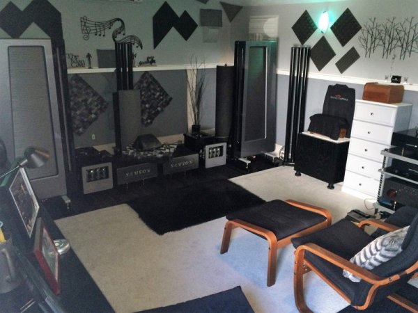

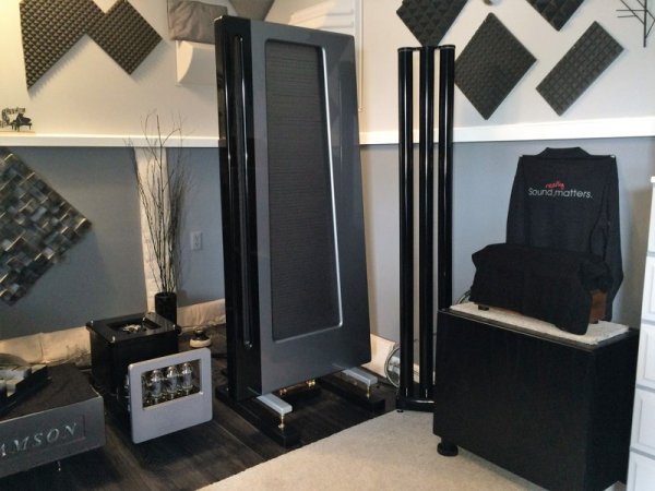

I then went to listen to the Duettas restored by True Sound Works that Lissnr (Grant) has in New York. Lissnr initially got the Divas, but couldn't fit the Divas into his 18*13 room, so a year later he sold them and brought in the Duettas, and is delighted with them.
He has his speaker 1.4m from the wall (which is more of a practical solution, Henk recommends 2m to get the best of the lower bass. Grant's also has 2m between the speakers, 3m to the headrest of the chair, and 0.27m to the sides. As you can see, a small room, as opposed to Henk's larger one. Grant has built this room himself over the years, and treated it, all DIY. Excellent planning for acoustics and power and relatively a budget set up.

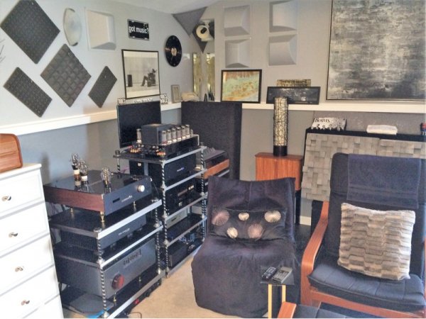

And yes, his source was the Lampizator Big 7 (who would have thunk I had a golden eared twin on the other side of the pond). Grant told me he had Sophia Princess 300b (which I don't like), so I took my KR 242s with me. Putting them into the Lampi immediately energized the room. The grip on each note was more, and extension was way higher. So was the slam and the dynamics.
The Mahler 2 slams gave me a similar flavor to what I had heard on Henk's FR, though on a smaller scale. The extension of the bass was glorious. Grant uses the Tube Research Lab amps and preamp, so it is an all tubed set up.
