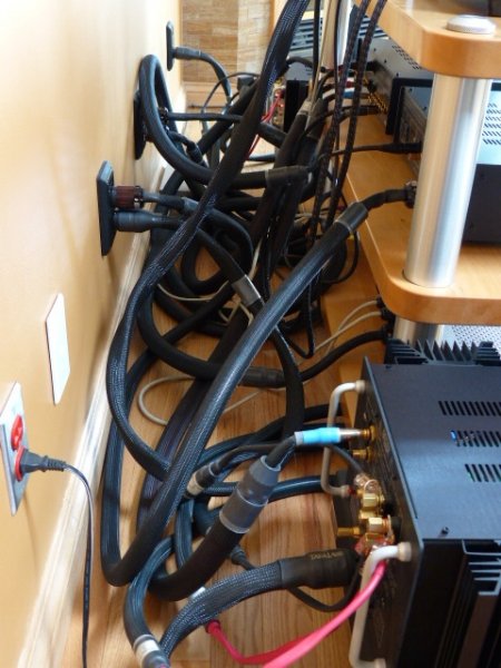

SURPRISE! Your outlets are installed UPSIDE DOWN.
Hospital outlets are supposed to have the ground pin on top.
Take a look at Leviton's website: http://communities.leviton.com/serv...2099-102-1-3203/Spec All HG IG Receptacle.pdf
It is a safety factor for hospitals to have the ground prong on top.
Having the heavy, longer ground pin on top will also keep your heavy plugs from pulling out better.
Thank you for the insight Gary. I wondered why the Furutech outlets have the brand label oriented in a way that appears the outlet should be installed upside down (as seen in the pic above). My mains cable is not entirely flush and had I installed it upside down the fit would be better. I hadn't considered this before, but it would seem the best approach is to have the ground hole in the opposite direction the AC cable is running.

With ALL those heavy power cords you need GOOD receptacles and you don't get those for $1.29

9 of my 11 power cords are very very lightweight Absolute Fidelity power cords from Genesis. so they do not stress the Furutech outlets. these power cords are so lightweight that they are not UL approved since you cannot step on them (they are not designed to hold up to being stepped on like most power cords).
the 2 very heavy power cords, Evolution Acoustics triple run power cords i use for my dart 458's, are supported where they connect to the Furutech outlets so they don't stress the connection.
