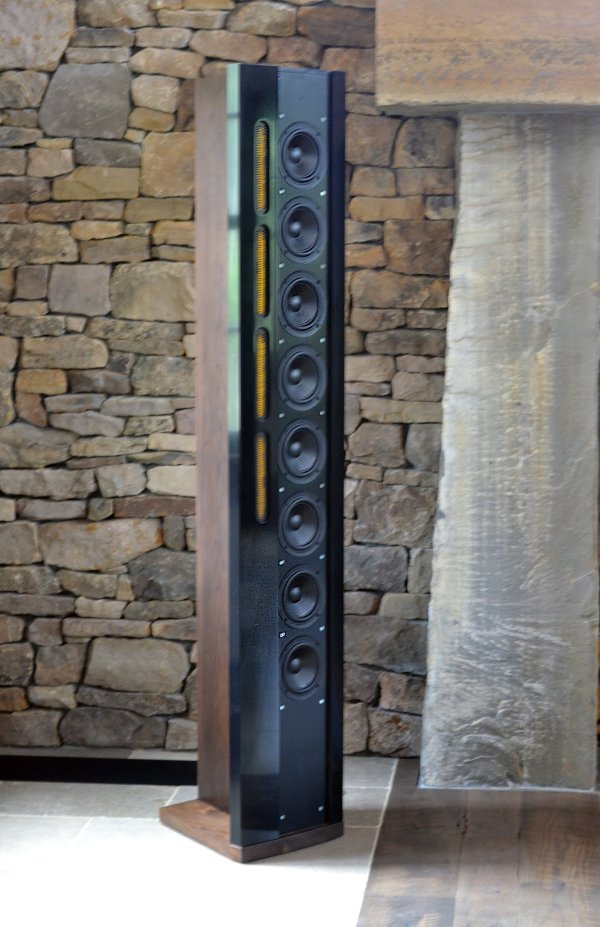

One experience brought this home to me. I was using a DEQX to provide digital crossover functionality for a custom built two way line array. This was only crossover functionality and not room correction. The DEQX did some “magical” things for the sonics, but it was also “taking away” some of the magic of the (simple, purist) analog crossover. In the end I still preferred the analog crossover most of the time. I then heavily modified the DEQX with better internal power supplies, better internal grounding schemes, high-end input and output transformers, better clocks, better shielding, etc. etc. etc. Following those mods the DEQX was better in all ways than the analog setup. What I had been attributing to “DSP” was more a result of the types of things audiophiles obsess over and not “the math manipulation”. My recent experiences with the SwitchX and AppleTV-X products were similar - the sonics coming from “digital” products improved materially with upgrades to their “non-math” components.

PS The array shown below was a three-way system with the subwoofers mounted into the floor:)
