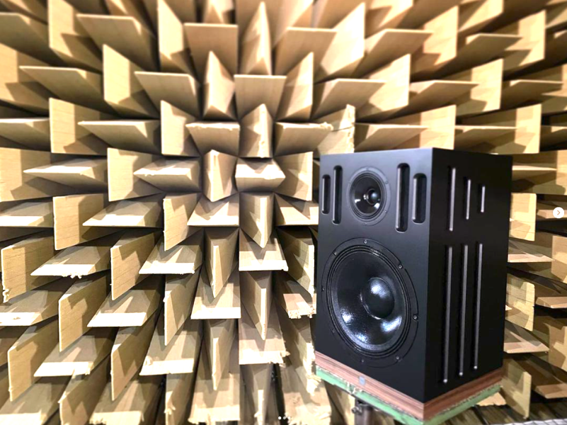

Hi, thank you! :) They are anechoic.
They are taken with the Klippel software in the anechoic chamber at Seas (I live around 20 minutes away from the Seas factory here in Norway).
