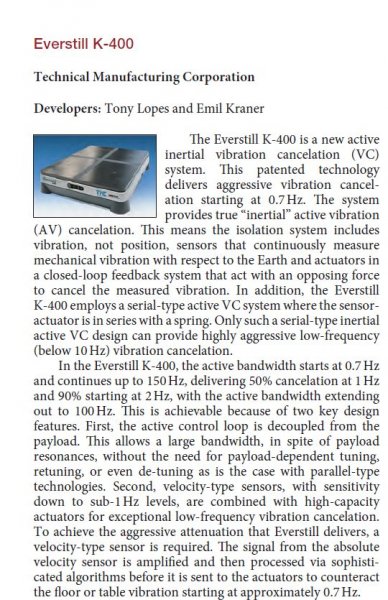

I think that the technology of various active devices such as the Kuraka does vary. on the surface one might assume they all have equal effect, but unless you actually compared them you might not know. I wonder who makes the Kuraka? maybe it is OEM Halcyonics?
