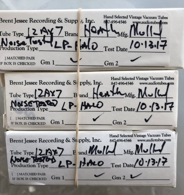

I think I am ready to tube swap in the Io Eclipse!
What are people using for V1 and V2 in the first gain stage?
Is there any reason to replace the 6922 in V7?
I have six Amperexes, six Mullards and six Telefunkens. I could swap out all three gain stages.
My primary sonic goal is to maximize tonal density. My secondary sonic goal is to maximize transparency and "aliveness" on vocals.
What should I do? The first gain stage? The first two gain stages? All three gain stages?
Where should I swap what?
Ron - the characteristics of the tone of each type of these tubes is accurately described on Brent Jesse's web site. His descriptions match my experience. How They Sound
Given your desire to maximize tonal density, I would recommend:
Mullards in V1, V2 and V3.
Telefunken in V5.
Find a nice quiet Siemens, RCA, Telefunken for V4 and V6.
V7 (the 6922) - use a Telefunken or Siemens. CCA is preferable if you can find them and want to spring $$ for them. 7308's are also very nice and not as expensive as the other variants of the 6922.
Rationale: the Mullards will likely have the richer/warmer (slightly) mid-range and the Telefunken will pass that through without
much change to the tonality.
If the bass is not to your liking, the shuffle them:
Telefunken in V1, V2 and V3.
Mullards in V5.
Rationale: the Telefunkens are very linear, the Mullard will add a touch of richer/warmer mid-range.
Hope that helps. Let us know how it works out.
In general, I use Telefunkens or RCA black plates in V1 - V6, Telefunken CCA in V7 and a 5692 to replace the 6SN7.
PS - those are nice tubes, you really can't go wrong with them. You will get more of their flavor if you use one brand in V1, V2 and V3.

Good synopsis @oldvinyl -- I do what you do. The mullard's up front are too much of a good thing for me with the Io. I like the V1-V6 to be TFK.<>
Reactions: Ron Resnick
Thank you, gentlemen!
What about splitting the baby, Nick? Instead of all Mullards, what about Mullards in V1 and V2, and others elsewhere? Would that give you a little midrange warmth without "too much of a good thing"?
I am thinking to try Mullard in V1 and V2, Amperex in V3 and V4 and Telefunken in V5 and V6 and V7?
I just discovered that 6922 = E88CC, so I have Telefunken E88CCs for V7!
I just discovered I have RCA GT 6SN7s for V8!
So I think what must've happened is when I bought all these tubes 5 to 8 years ago I must have had a head full of steam to buy tubes to be able to swap out everything.
And just to be clear, so you guys replace all of the stock tubes V1 through V8?
I replace all the tubes Ron.
You can certainly split and try the mullards up front and TFK down the line. TFK ECC88s are very nice and good examples are rare- nice tube .. I use a USN 6992 Amperex in that spot and use a 5692 RCA red base for the 6sn7 position.'
There is no wrong way Ron just try. I would use your combination then move the telefunkens forward to see what Oldvinyl and I are talking about from our perspective .
Quietness is most important. The other aspect is gain. I find the Telefunkens to always test lower for gain than most other types and certainly lower than new Russian types. It doesn't make much of a difference but its there.
Have fun.
