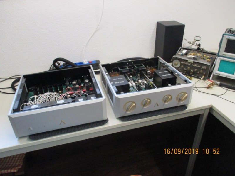

Repair of Aesthetix Callisto in Germany. No need for transatlantic transport.
Now the big question for me, where in Germany are you located Reinhard ? :)
Hi Reinhard,
Are you an Aesthetix factory trained and authorized service center in Germany?
No, but 50 years experience with medical and high end electronics .
Ron, as you are in the USA it is not of interest for you.
This Callisto was from Hannover and the customer got it back after some days.
