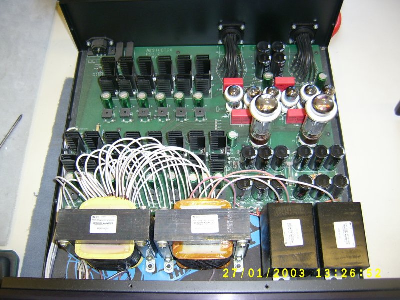

Not an IO, but Rhea signal path is the same, power supply and current sources are solid state.
Rhea was in for repair, new tube sockets and upgrade to better coupling caps. Here Mundorf Supreme.IMG_1459.jpgIMG_1460.jpg
Nice work. The one thing about the Aesthetix product is that they are for the most part one board designs and there is no easy way to service them based on the way they are mounted. I imagine the factory has umbilicals and such for the power transformers so that you can work on them on the bench. With the Io and its power supplies it would be a nightmare.

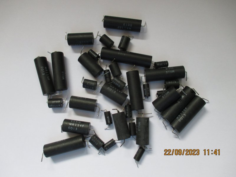

One of my first IO repairs, back in 2003. Had to change all the black Mills Resistors because their resistance was not stable.S4200132.JPGS4200134.JPGS4200135.JPGIMG_1466.JPG
