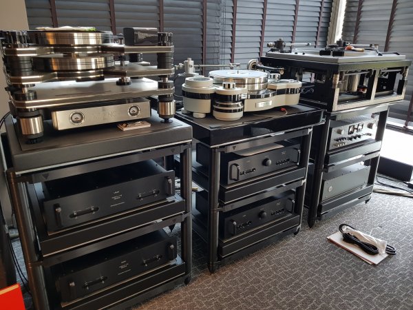

Ok Tang, your dog likes Lamm, now what is your initial impression ? ;)
Micro told me unless the gears are at their full potential, I better not say anything. ;)
Kind regards,
Tang
Great pictures - can I ask what are signal and speaker cables? - I think I have guessed what are the power cables!
Kuro. The Kuro strengths are super clarity, very open airy, outstanding nuance and high is a cousin to tape. Gian can tell if I am wrong.
Tang
