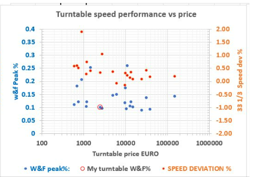

People must stop believing that more money will buy you a better turntable, there is a very random correlation between price and performance In fact I have measured the speed performance 0f 50 000 usd TT that are worse than a TT at 500 usd. Must high end boutique turntables cannot hold speed any better then a cheap one. so check before buying. I you want to spend 50k on a TT a ShaknSpin fir 200USDv is a good thing to buy first , then you can see if the most basic TT parameter is in order, most of the time todays TT are not very good compared to vintage TT
People must stop believing that more money will buys you a better turntable, there a very random correlation between price and performance In fact I have measured the speed performance 0f 50 000 usd TT that are worse than a TT at 500 usd. Must high end boutique turntables cannot hold any better then a cheap one
Although speed stability is important, it is not what sets turntables apart once speed stability is above some threshold.
