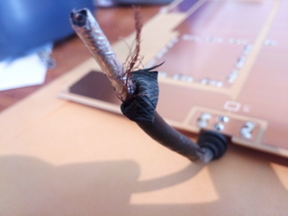

This TERK outdoor antenna comes with a 6 foot cable and a booster. The booster is near useless and adds noise. The cable / connection quality is also ridiculously poor, and built to fail ...
notice the tiny ground/shield wires ...
... crappy tiny material; so brittle, as to be near useless. They can snap simply by looking at em.
In time, these will fracture internally, and the antenna will fail.

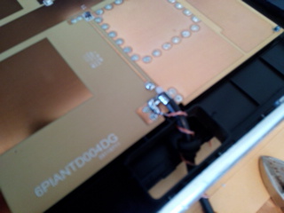

Bypassed as much of the crappy coax as possible, added an external ground ...
... and even managed to utilize & solder their crappy connecter ...

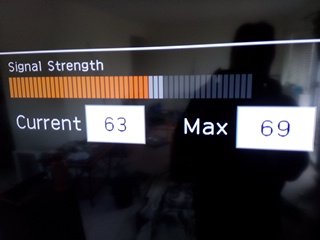

Testing signal strength - without any care of unit placement - (pre mod, ~ 45 to 55 on a good day) ...
