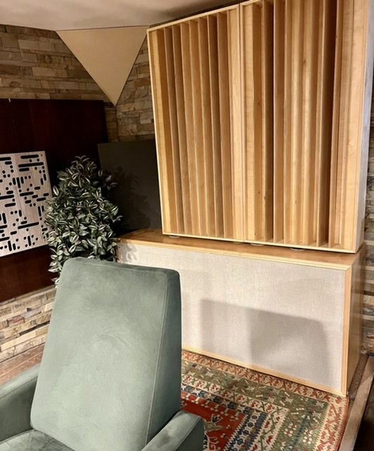

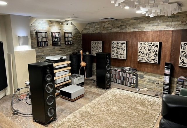

I think this depends on budget and how kooky you want to get! I have treatments, seen and unseen, in multiple places. And constrained layer walls. And DIY can be excellent, BTW. The quads and 165lb. trap were build here, by me, from plans. Exciting project! Have fun.

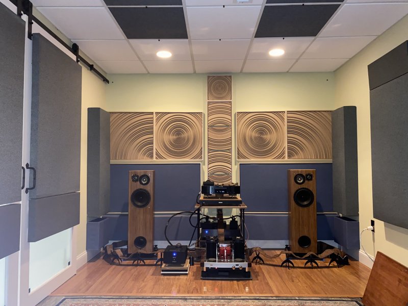

Suggest you also take a look at DHDI whose ZR Acoustics panels have been dramatically better in my listening room than conventional absorbers and diffusers:

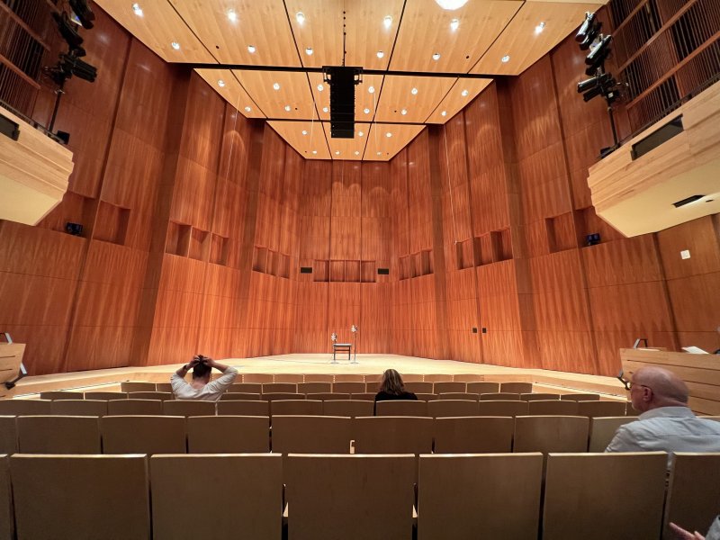

@Crossram I think there is a benefit to having non-parallel walls or ceilings, although I guess sloping the floor would have some potential downsides in a home.
Although I cannot provide the mathematical proofs, I think non-parallel surfaces act more like diffusors or reflectors that reduce destructive/reinforcing wave interactions (although over-all sound pressure could still be a concern to be managed).
Here is a photo I took last night. Hatch Hall was purpose built at the Eastman complex; it is one of three main facilities there.
This won't be news to you or anyone else, but many music halls have angled walls (and often sloping floors too). You cannot see it well, but this room also has highly baffled side-walls. IIRC they are tunable.
I was thinking last night how interesting it was that the front/stage is so highly reflective sonically, when home listeners often deaden the front wall, although I suppose that is an on-going debate: live end/dead end. And musicians need to cast their sound out to an audience, without volume controls our amps provide.
I have tried adsorption and diffusion on the front wall, and a combination sounds best. I have multiple bass traps there, but I put diffusors in front of the traps. Those bass wave forms are huge and very powerful: we are not stopping those babies when they get going (think trash-truck rumblings or trains if you live near one).
I mentioned my room is highly treated, which I did a bit at a time, listening along the way. If I had the capability at the time, I would have measured the room along the way for a more scientific approach.
I live in a condo complex which is built in an arc, so one side of the home has a 23 degree angled wall on three floors and the basement, of course.
I worried about the asymmetry of my room (and had I listened to Dennis F. I would have abandoned audio altogether. He essentially said my room was junk), but it's what I had, so...
The walls have "Z" clip rails across the studs. This is a basement, BTW. Homesote is screwed to the metal strips. A thin layer of pliable adhesive was applied to the homesote, and drywall screwed down to that in the usual manner. I believe this concept to be valid, but it was done with the materials and knowledge of the day (25 yrs ago?).
My various treatments were added many years later, piecemeal. I think the sound is very well managed in the room, although at just under 8' I long for a taller room.
Although you can get an over-all plan for your space, IMO you are first dealing with your walls and ceiling structures. That stuff you can't really change post-build. Problem areas can be managed along the way, although some of them can be predicted to be problematic (corners, for example).
One of the key elements, IMO is where your gear will live, and your listening position. Will you be near or far from the speakers?
Although I read until my eyes watered and considered many things, it wasn't until I put my speakers into my intended location that I found a real problem: Who stole my bass?
It turned out my listening position was essentially in a null-location, low frequency waves cancelling each other out. Highly practical lesson in the physics of waves! I was crushed.
I had to change everything, moving and listening over time. My speakers are much further from the front wall, and I am now about 9' away. That seems the best balance for detail, soundstage and overall presentation.
OK, well sorry to blather on with a long reply to your very concise question about non-parallel room planes. I think they could be helpful to consider modeling, if you can manage it in the build phase, budget, etc. as a room-within-a-room.
