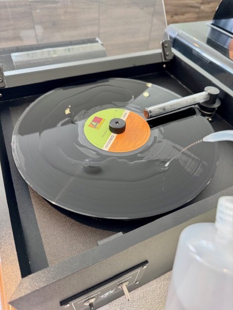

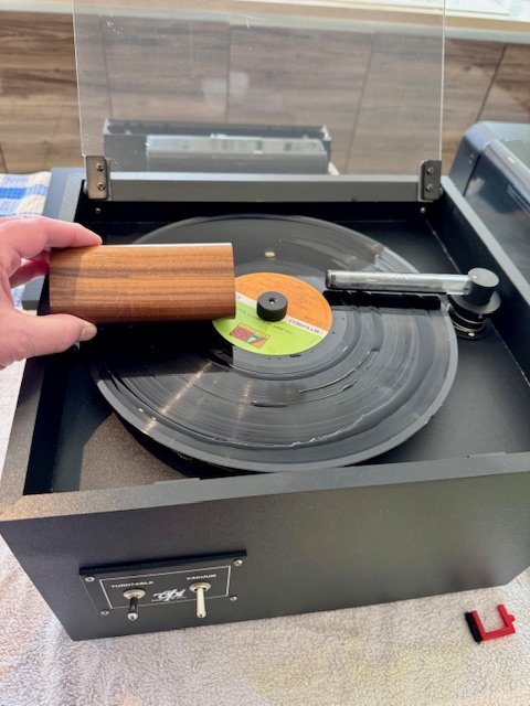

At the end, I dry the record by suction on the Project record cleaner (10 rotations each side).

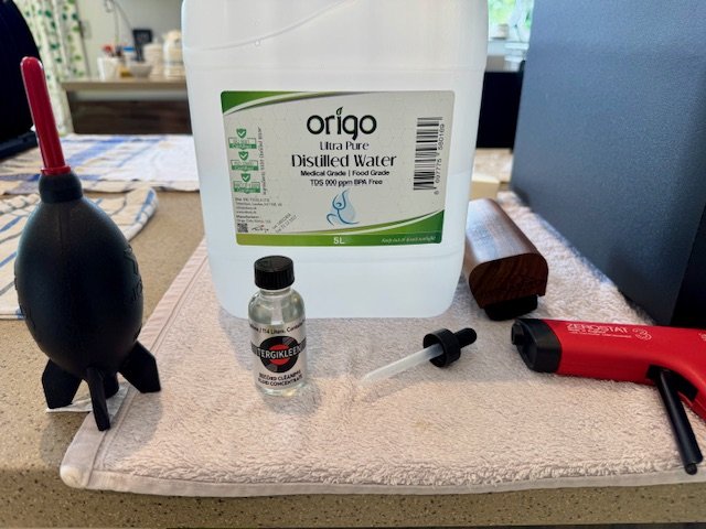

Do you 1st rinse the record with distilled or demineralized water (DIW). Depending on how many records you clean with the same DG-II bath, after every record, the bath Tergikleen concentration is increasing. If the concentration gets high enough (which is much less than the prepared solution you brush on) when you dry some of the solution is evaporated on the record and Tergikleen residue will be left behind.

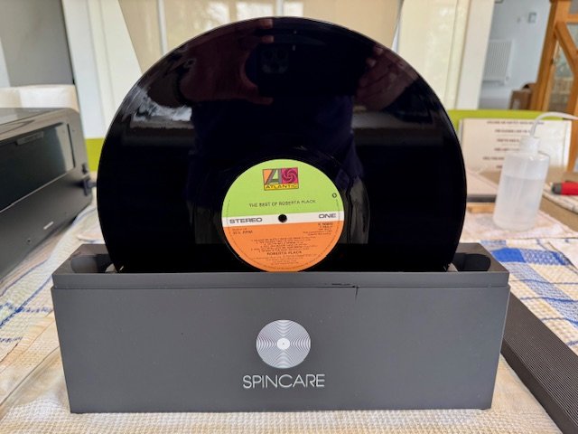

Have you tried just using the new Degritter Cleaning solution (about 1-ml/tank) followed by a rinse (use a 2nd tank)? Using the 2nd tank rinsing process helps to keep the temperature under control. With the 2-tank clean-rinse process, you may be able to cut your process time down to about 12-min (with the DG drying the record); using your vacuum-RCM for pre-clean only as required.

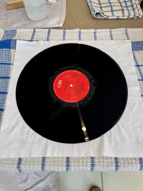

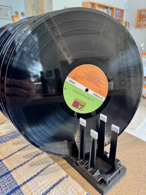

Hi Neil. I am taking one step at the time. I still wet my records with Tergikleen before cleaning, but now use a second tank with distilled water only for rinsing, as you suggested. I did not relize that the DG2 offers a streamlined 2-tank workflow that makes swapping out the tanks very convenient. The whole proces now takes 10 min/record, including a final drying on my Project machine: 2 min wetting, 7 min DG2, 1 min drying. And no adverse heating up of the water in the tanks as I keep the tanks in a fridge next to the DG2, also between swaps. 6 records in 1 hr. Not bad.
