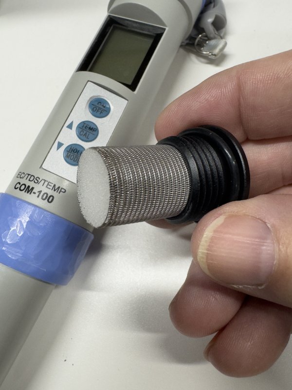

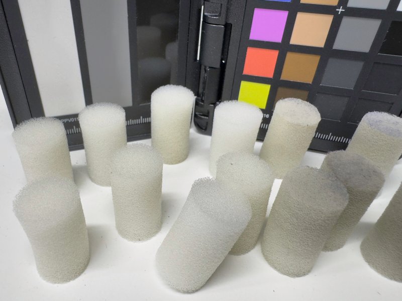

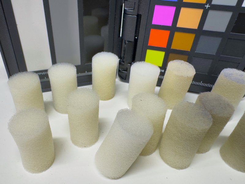

Sorry, @tima I haven't been keeping up with the thread. Here are two images taken in Feb. 2024 of Degritter MK II filters, all pulled after 50 rotations (the counter is based on rotations, not discs cleaned). The second image is the same file, with saturation boosted so the yellowish color of some of the contaminants is more visible. The shot was taken before I began using the pre-cleaning method I use today (briefly, multiple cleaning steps with multiple rinses on a VPI MW-1 Cyclone). Once I I upped my pre-cleaning game, the spent filters became much cleaner, with very little yellow contaminants. Current process uses three separate tanks, with only the first tank containing cleaning solution. I normally process about five records at a time, so tanks get swapped after each batch is processed.

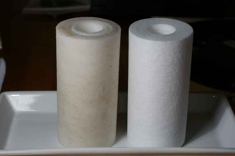

When I built my first ultrasonic tank -- back when I knew nothing -- I included a small filter along with a pump made from a hot-drink dispenser. The picture below convinced me I was on a good path and eventually adopted more and more aggressive filtrations. 84 records cleaned (L) brand new filter (R)
1 micron (nominal) particle retention

To your question, the tiny Degritter filter is hidden inside the machine and can only be inspected by removing it and pulling it out of its housing. You could do this at any time the machine is idle, but doing so would be a pain and IMO not worth the effort. As you can see in pic 1, (a new housing and filter) the filter housing includes a screen that presumably catches very large bits, although I've never seen much on it. Some contaminate types will adhere to it, so cleaning it prior to re-use is important (I do have three housings in rotation). One nice thing about the COM-100 TDS meter is its cap is exactly the right size for the filter screen. Pour in some 99% IPA, set the housing in and it will clean up nicely overnight. The filter housing's cap seals the top of the COM-100 cap.
The well that the filter housing screws into also needs to be inspected and flushed out whenever one changes out the filter. I've had occasion to find larger bits clinging to the edges of the inflow and outflow holes.

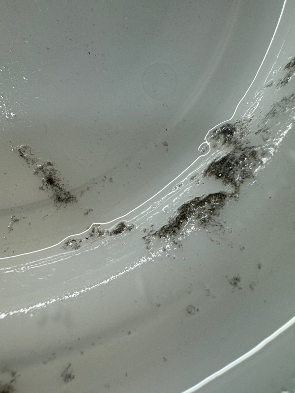

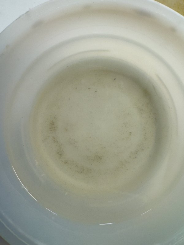

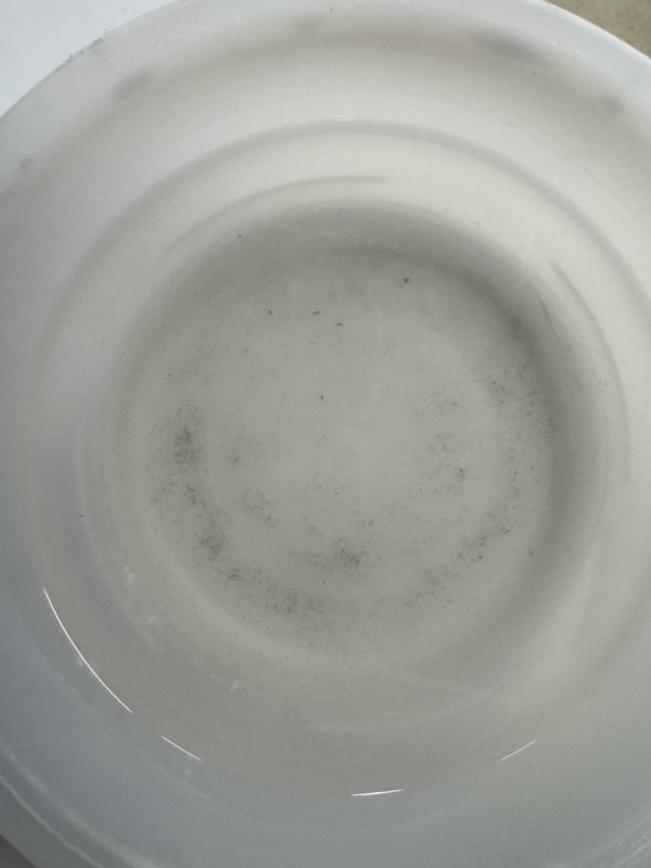

For a time I experimented with cleaning the filters themselves, simply because it seemed a waste to have to toss them after 50 rotations. I was never satisfied with the results. Pic 2 shows a 99% IPA bath after soaking a batch of spent filters. Pic 3 is the same image with saturation boosted to bring out the yellowish tint.
Pic 4 is a closeup of the residue remaining after pouring off the IPA. My inspection of that residue included rubbing some of it between thumb and forefinger. Much of that black stuff is quite soft. I won't say what my conclusion was as to its origins, but will say that at that time I was using spin-cleans for my pre-cleaning process and that I have since abandoned them.
I want to reiterate that these images were taken prior to my current pre-cleaning process. Once I put the VPI MW-1 Cyclone back into service as a pre-cleaning station, my Degritter filters after 50 cycles were much cleaner. Most of the yellowish tint was gone. The overall coloration now is usually a pretty light gray, much lighter than any of the spent filters in the pics from my previous post. At this point only hot off the press new issues that ship in poly inners go straight into the Degritter. Even those older pressings I acquired still sealed go through pre-cleaning.
