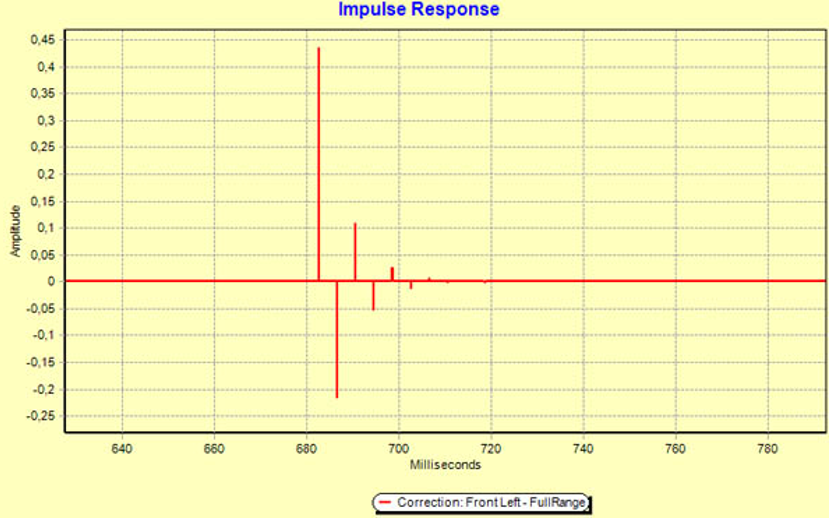

Early reflection will smear out the direct sound, confusing the human psycho acoustic hearing mechanism, to hear two sound sources, to close in time, to be separated. Early refection will be from room surface, but also cabinet diffraction.
Though you can´t change the rooms late reflection pattern with DSP, you can to some degree remedy early reflection problems with the best DRC programs.
Reactions: OrigTweaker
I know it is a bit controversial, but 1. reflections, can to some degree, be remedied by counter signals generated in DRC software combined with group delay correction, that can be beneficial. The correction will of cause generate new reflections, but it will also be remedied by counter signals, for as long as the filter is running. Something like this.
I know well what yo'ure talking about and heard systems many times that does this. But when you have myriad of reflections arriving at different times, superposition between drivers and speakers it doesn't work without adding artifacts. Plus part of the frequency area is too small in regards to the wavelengths and will either not work for both ears or when head is moved sligthly.
One should EQ what's minimum phase behaviour only IMO.
Yeap, as I said it is a bit controversial. And I think you are right, that minimum phase is most "safe" to get in order. On a personal note, the best systems I have heard was with DRC. I have tried to do my own convolution filters in REW combined with Rephase, but I can never beat the result that a well tuned filter from DRC can give me. Maybe my REW and Rephase skills just sucks? :)
