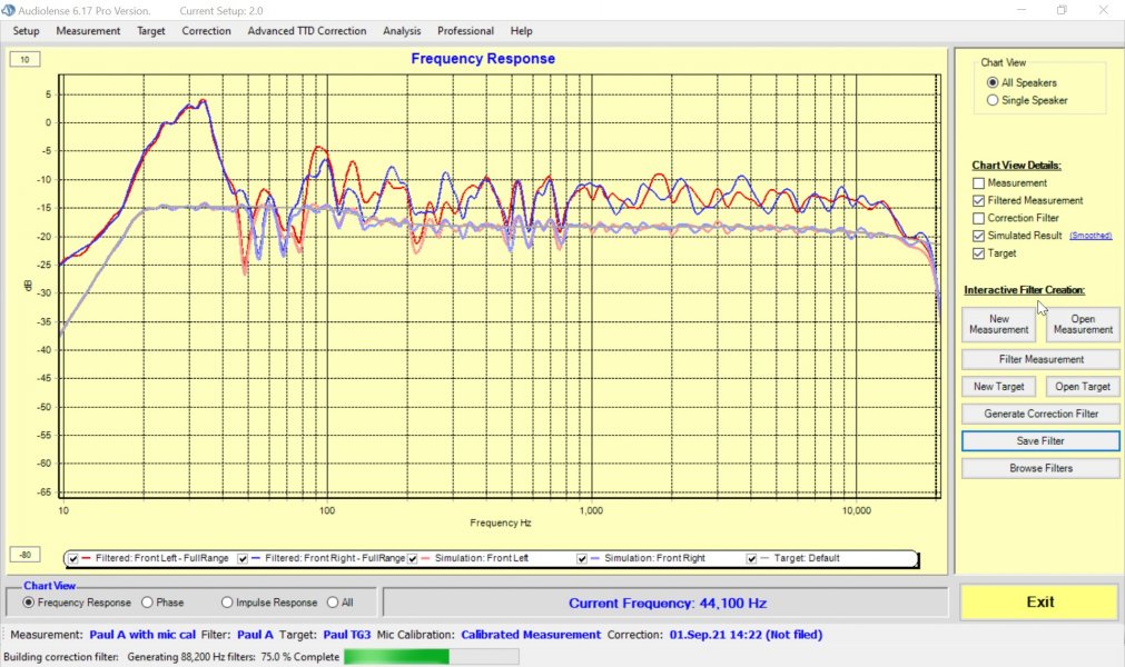

This is the before and after response of the TADs in my room with the speaker close to the corners. Note these R1s are actively biamped using a Pass XVR1 set up by Andrew Jones. The LPF in the TADs for the woofers is bipassed. The internal crossover for the coax is still in place. The woofers and the coax each have a Benchmark amp driving them in mono.

PGA, this is an impressive but also somewhat interesting (to me anyway) result. It looks like you’ve got boosts of around 5dB or more between about 50-80Hz. That seems like a lot of boost at such low frequencies. I thought that was a no-no.

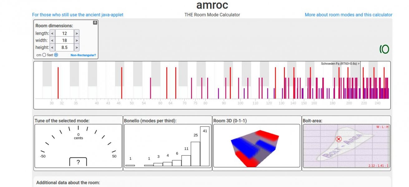

You would need very large bass traps to fix the bass problems I have in my smallish room (12x18x8.5). It’s just not a practical solution. What ended up working extremely well was placing the TADs essentially in the corners along the 12 foot wall and eliminating the bass boost with DSP
Using the old bolt area methods, the room is long, but only wide at one end because of the self cancellations. If you use the mode method you might be able to clean most of it up, But like I said before, most effective bass traps are customized for the installation.
Here is your room in a mode simulator : https://amcoustics.com/tools/amroc?l=12&w=18&h=8.5&ft=true&r60=0.6
There are two sets of graphs, the darker ones are before DSP, the lighter ones after. I don’t see any peaks in the after DSP graph, just the dips that are caused by the room and a gradual Harmon curve slope
