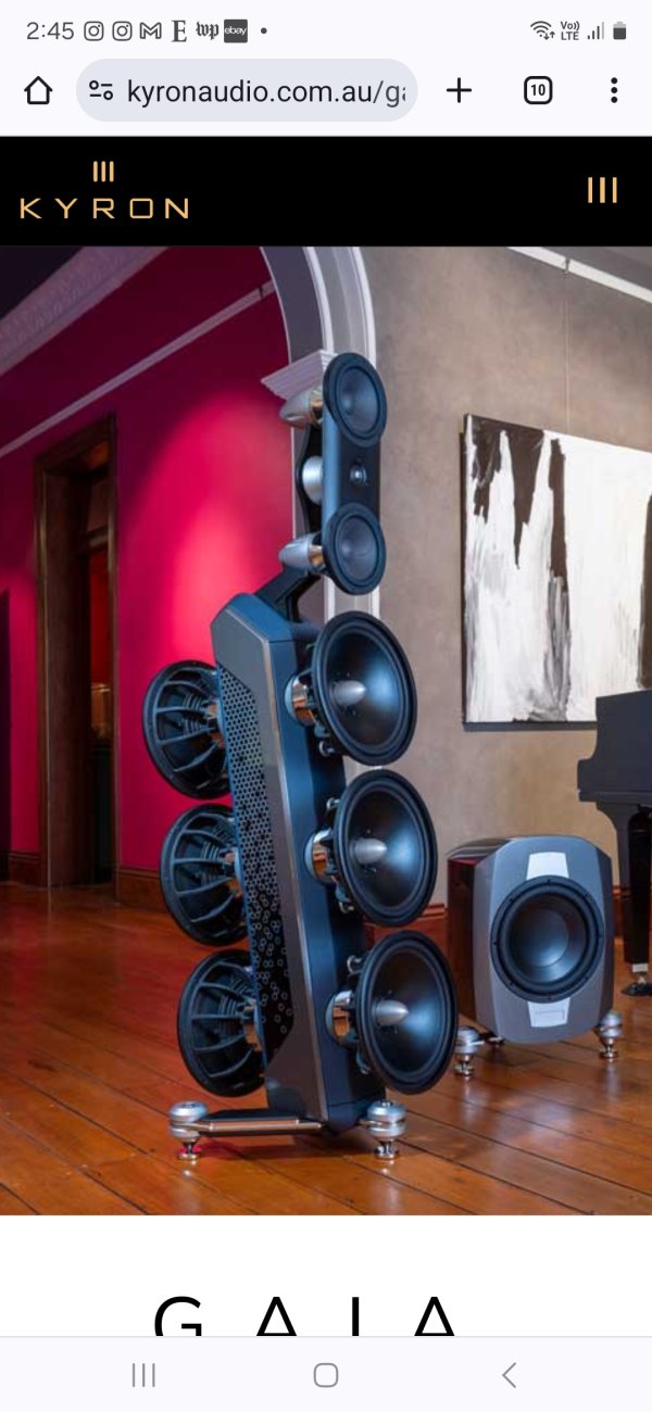

The steinway lyngdorf and kyron gaia are two high end attempts. I have heard the gaia and it is super impressive and I know they are currently upgrading amps. DSP makes sense for dipoles for the shelving ability which may explain the above uses but it would be fascinating to hear their front ends on a system like yours. Of course the question of analogue input is another thing alltogether
Like Bjorn I have no doubt this is the future

something like this might be a starting point. but don't see that it has any integral dsp.
not exactly a real world answer. but it does show someone is thinking about it.
