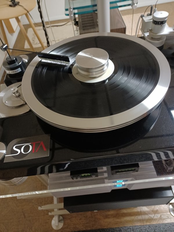

There is a built in clock in your AS 2000 controller too Peter, it uses digital technology :eek: to maintain a stable electrical power."The unit uses an Atmel AT89C52 microprocessor to control the DDS circuit, the display and accept commands from the user. The clock source for the microprocessor is an 8.388608MHz crystal oscillator with a frequency stability of .01% (100 PPM) and also serves as the reference source for the DDS."
Yes, I have taken apart the motor housing to inspect the various parts. I have played around with the voltage and frequency adjustments to listen for differences, smoothness in operation, etc. With the larger separate Esoteric component box, I thought perhaps something additional is happening. I will be curious to read what Mike discovers.
I assume that all SOTA tables have very precise speed stability. With all due respect, did you hear any differences?
relative to my current tt's, which are all outstanding on speed and flow, as far as i can tell the Esoteric T1, in stock form, is a cut above my others as it is now. but i don't have my reference arms and cartridges mounted so my perceptions are provisional for another month until i get the arm boards from Esoteric to mount my arms.
and certainly i do hear musically significant speed differences between my turntables, including the now departed Saskia. these are not issues of good/bad, more complimentary to particular music.....other than warm up kinda things.

I have a stand alone motor assembly so I'll adjust belt tension to achieve the fastest speed the adjust the freq. to get to33.33 rpm. I think in my case too much tension puts too much of a load on the motor bearings thus slowing the platter down. I'm going to find my manual and play around with different voltages. Thanks for the info!

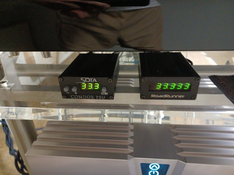

Yes, this is one of the interesting questions to ask about this table. As in Mike's pictures the table has a digital readout - the picture shows 33.33. It could be surprising if that changed with the added clock.
To get that readout I wonder what is measured - is it platter speed and if so how is that done? ....
I wonder what differences would be noted if the display had an additional place of precision?
It's just one aspect I appreciate about the simple but effective SOTA/Phoenix Engineering drive system. With a sensor on the platter's bottom edge the system measures platter speed per rotation to 3 places of precision.
I’m not sure if roadrunner displays sensor readouts or mean value of a certain integration time. In any case there is another easy way to determine platter speed changes. It’s using an iphone and RPM app. It shows change in speed instantly together with wow&flutter. RPM is not a reliable source for measuring these figures cause it may display speed 33.50rpm when the actual is 33.33rpm. On the other hand it’s results are consistent. Additionally it’s very reliable to detect changes in speed and wow&flutter.
The app is very useful to see instant speed changes but I don’t recommend bothering with calibration in the app. I set up my table for 33.3 and 45rpm using test records and computer software and immediately check the speed with RPM app. Whatever number displayed by the app is the calibrated speed (including cartridge drag). For example using my iphone 12’s accelerometers the RPM app reads 33.54 for 33.33 rpm. YMMV.
From the Condor PSU manual:
"The tachometer outputs the speed reading once per revolution. The PSU compares this reading to the speed on the display and can make micro-fine adjustments to the output frequency to lock the turntable speed to within ±0.005 RPM. The adjustment is done slowly and evenly over the entire next revolution and is inaudible to the listener (in most cases, the adjustment is <0.0005 RPM per step). The turntable remains on speed independent of the belt tension, bearing oil viscosity, drag from the needle or any other variables that cause the table to drift over time with speed."
