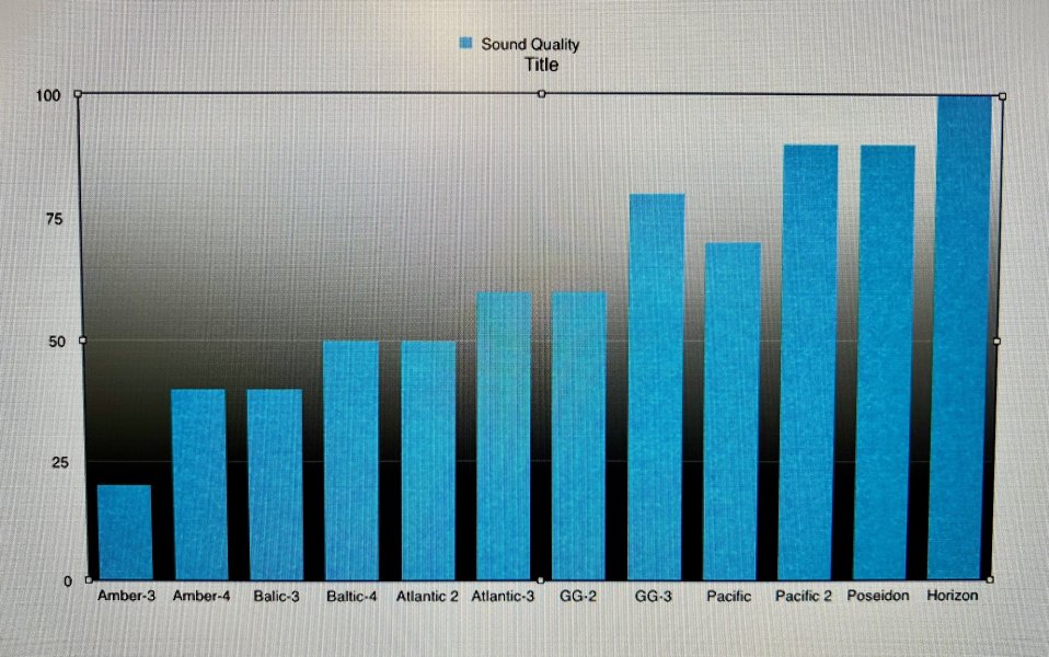

I see a few posts in the thread, where people want to know how Poseidon compares to other Lampi models. I know most on this thread are familiar with this chart, but in case it is helpful to those that haven't seen it, here is a pixelated iphone pic of the comparo chart from Lampi:

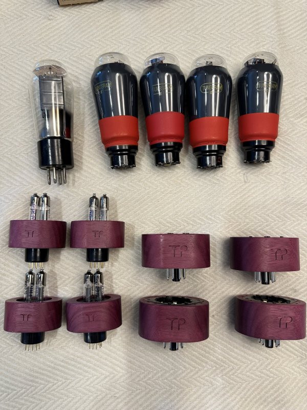

Here is a full set up for the Posseidon.
can you share more details on what I'm seeing? I'm new to lampi tube rolling so can't recognize anything here. How does it improve the sound in your experience? thanks!
Tungsram PV4200 rectifier, Tungsram El6 and double subminiature tubes instead of the 6N1P. All with our TP adapters. It will improve the sound in every possible way:)
The impact is huge! Almost a component upgrade.
Which subminiature tubes are you using?
