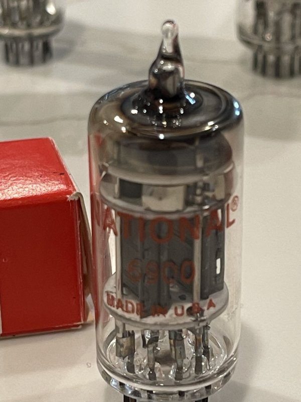

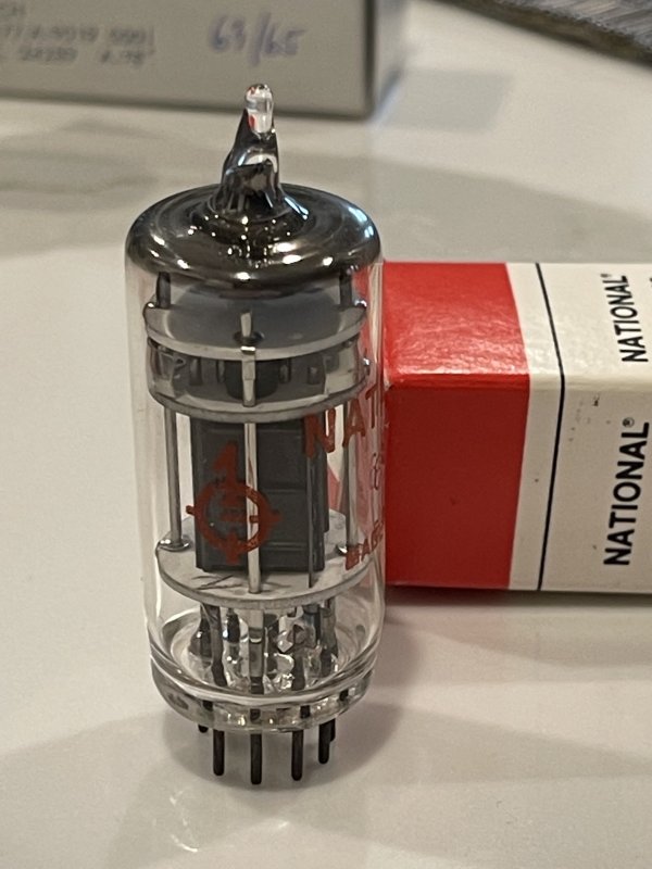

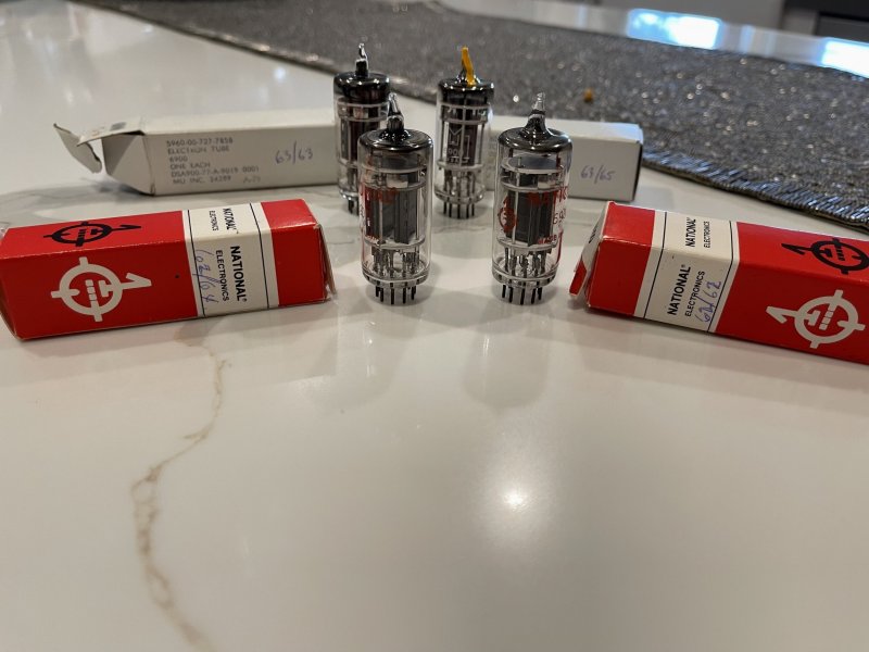

These little guys just arrived. I bought two matched sets. In fact the 4 tubes all measure as new and are in essence a matched quad set
@wisnon.....do they need an adapter for the Horizon?
The yellow tipped one is so designated as it was cryo treated and is a small amount of paint
What I just learned is that the tube although looking like glass is actually made of ceramic and can sustain very high temperatures
These are made by National as well as Mu. I was told that Bendix only made 300 of these tubes before they sold the machinery to Wu who also manufactured the tube for National.
I was told that a set of these tubes will outlast us all

measurements of each tube . They measure new

The sockets in the horizon are 8 pin and for 6SN7s so they will definitely need an adapter.
