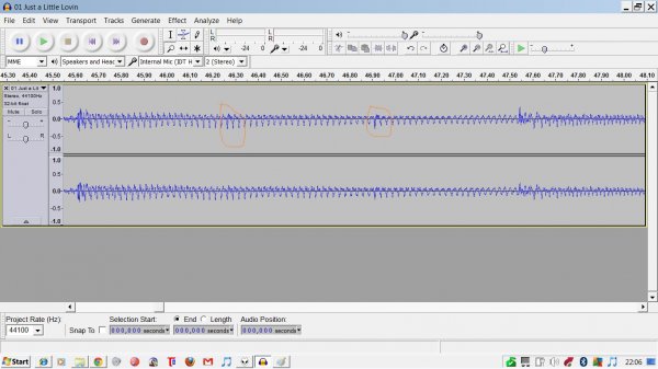

I'm looking at it in Audacity & at 0:46.15 & at 0:46.95 there are two disturbances in the waveform which I'm no good at interpreting - it looks like it might be oscillations riding on the bass note wave. It certainly doesn't look like the note starts & stops 3 times. I'll try & extract this & also a pic of what I'm seeing in Audacity.
Looking at it more carefully & comparing it to other bass notes - the stuff riding on the waveform is the beginning of a bass note pluck -it is the same waveform as starts each of the bass notes earlier in the piece.
So, unless someone corrects my interpretation, Audacity seems to confirm in it's waveform trace that there are 3 plucks of the same note in this section of the WAV.

Tim, if you look at the section of the track in Audacity that I noted the timings of you will see the waveform that I mention. I don't think we are talking semantics - you hear it as a bass slide & so do a lot of others. I'm saying that it is two plucks on that same string, giving three of the same note in quick succession

Screen shots attached:
The first one shows what I'm talking about & the times are correct. There are no more bass notes after this - it is what you are calling the "bass slide", Shelby starts singing a second or two after this
The second is a more zoomed in pic (ignore the timings on this one as Audacity seems to go astray on timings after a move
If I were looking at that graph, I'd say there was either a polarity or DC offset issue as well.
Can you educate me Bruce, I'm no expert in this?
