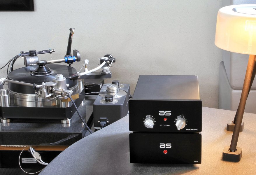

From a lover of the Miayiima BE I got this message last week.
He means in context One Channel, Ortofon's new A MONO system should definitely be counted among the top mono pickups when it comes to true mono, i.e. purely single-channel.
A single coil with a very special, sharply cut diamond. It extracts even the smallest micro details from the groove, which have remained hidden until now. This -TRUE MONO-, One Channel technology, has also been consistently implemented by the German manufacturer Audiospecials.de with its AS Monophonic -TRUE MONO-. The combination of Ortofon A MONO and AS Monophonic -TRUE MONO- in interaction has been described very convincingly by Audiocirc.com in a detailed report.
The -TRUE MONO- One Channel, Phonopre AS Monophonic was connected to the Ortofon A Mono
Monophonic Details info@audiospecials.de

I recall putting a straight-through mono system together - modded Lenco, SME 3009 tonearm, Ortofon mono cartridge, passive pre, Leak TL12 monoblock, Quad ESL 63. For the phono stage, Nick Gorham of Longdog Audio in the UK built me a mono phono stage with variable EQ. It was quite fun though I concuded in the end that I prefer my mono coming through two speakers - the space in the middle allows more lattitude for the mind to sort out the various stands of the signal, and in particular to allow image depth to develop.
The phono stage Nick did for me had the standard controls for the EQ curve, which are Turnover and Rolloff. (There is also a third element which varies bass shelving, shown by letter after the Turnover number - though I've never come across a phono stage that has a separate control for this).
See here for a reasonable selection of EQ curves, though this is far from complete:
Dials for Rolloff and Turnover is how my current Allnic H7000V is configured, albeit it doesn't have the full range of a transcription phono stage (offering four options per setting rather than six). Nevertheless, it covers off pretty much all LP settings, as well as the majority of 78 curves with only a few (generally very early) left unavailable. I previously owned a Slee Jazz Club and an Esoteric Re-Equalizer and I'm not sure I actually used in practical listening any settings not available on the Allnic.
Anyway, strictly speaking a full transcription unit variable EQ phono stage should have something approximating the following available:
Turnover: Flat, 300, 400, 500 (RIAA), 600 ('LP'), 700
Rolloff: Flat, -5, -10.5, -12, -13.7 (RIAA), -16 (NAB)
Any reason why this AS phono stage has implemented something different to the industry standard? How do its two dials labelled 0-10 map to the above?

montesquieu,
you have analysed the normal approach to correct equalisation very well!!!! Chapeau.
The advantage of setting the correct equalisation, by means of two numbers, called EQ CURVE on the AS Monophonic has quite practical reasons. Most mono listeners have no desire whatsoever to deal with technical questions of correct equalisation. They want to enjoy their mono records authentically, uncomplicatedly, but at a high-end level. Especially the mono clientele is characterised by a high level of repertoire competence.
That's why equalisation is done by means of two numbers on the front of the grille. The left knob stands for -Bass boost-, the right knob for -Roll off-.
Example RIAA Curve = 4.5/4.5
All twenty internationally known vinyl equalisations can be set according to this scheme. All twenty!
See the List.
Which device can do this in such a simple way?
An additional highlight is. It is stepless. So it is also possible to create an intermediate value.
On the list Mono EQ Curves you can see all international mono vinyl equalisations with the corresponding EQ code.
The same applies to shellac. Here, too, we have about twenty listed. Our reference list is the Midi magic. It's just a fantastic list. I love it.

The problem with using curves named after labels is that most labels changed the values they used over time, as many as twice or three times according to date, and on occasion they are different between the same labels pressed in the US, Europe and Japan.
Using a stepless arrangement to allow intermediate positions is useful (the custom one Nick Gorham did for me also had that facility) but I don't think it's a good idea in the least to invent your own scale and interpose it between the original well-established and documented values, and the user.
Also the notion that there is somehow a list of 'all 20' curves is misleading, as in fact there is no definitive list of 'named' curves, only particular values used by particular labels at particular locations at particuar times.
Whoever dreamed this approach up is no doubt enthusiastic, but I'd be prepared to bet he didn't run the idea past any long-standing mono collectors (or indeed archivists) before taking it to market.
Seems like this is an issue of identification. It may have been preferable to identify the numbers that relate to each degree turn of the pot with a numerical value versus a 'label', so the user can make a more specific decision, although this doesn't change functionality. Range of adjustabliity is really whats being discussed, no? In this case I am sure the chart can be adjusted to reflect this...
