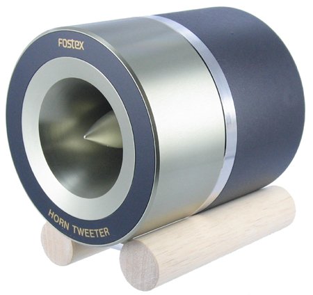

I had some success by adding Fostex t925a supertweeter to Altec A7 resulting in more air and sparkle.
But sometimes I got the feeling that I got too much sparkle or even ringing.

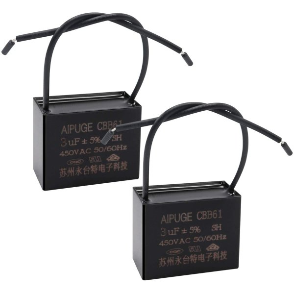

Thus I ordered some 3uF caps from Amazon to have cutoff at 6.6 Khz instead of 5khz.
Although above two caps have same capacity, the latter appeared to give slightly sweeter sound.
Eva Cassidy's beautiful voice appears to have enough sparkle and clarity but without too much sibilants.
This Korean song also sounds right with good speed and rythm.
I will also test 2.5 uF and 2.2uF caps which give 8khz and 9khz cutoff respectively.
If I am set at the most desirable cutofff frequency, then I may order more expensive caps like Mundorf or Miflex caps. :)

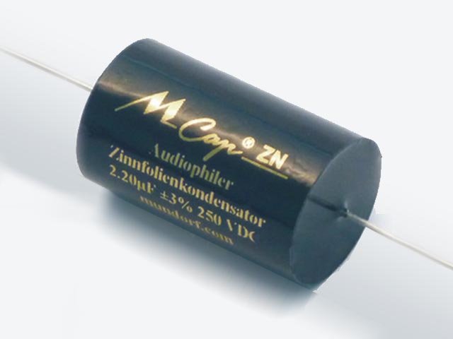

you will be surprised how heavy the tin foil capacitor is, it is very good at inhibiting vibrations
I always use this to keep the highs clear and resolving, not disturbing. a great capacitor

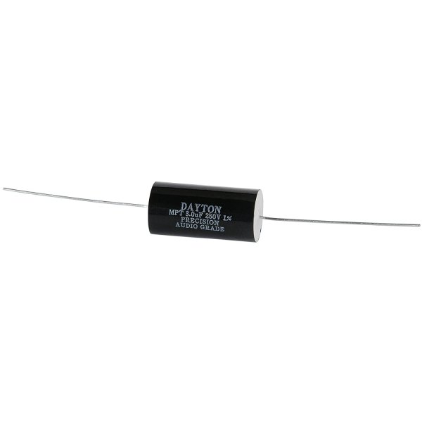

I also ordered 9 ohm (12 watts) Vishay register (also using 3 micro F cap) to connect Fostex tweeter to amplier directly bypassing internal network.
It may sound more transparent. ;)

You need to also consider the phase/time alignment of this supertweeter. If that is not correct you can create interference with the Altec that will impact the perception of balance considerably. It is not so simple as a crossover and plunking the tweeter down on top.

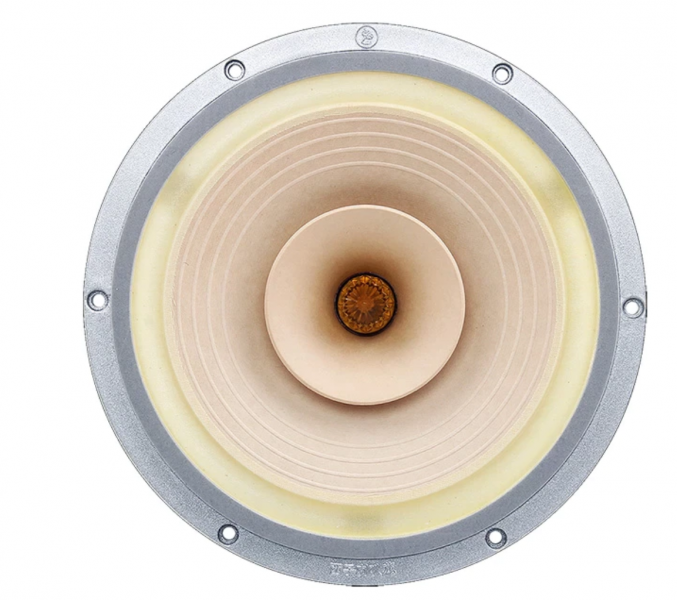

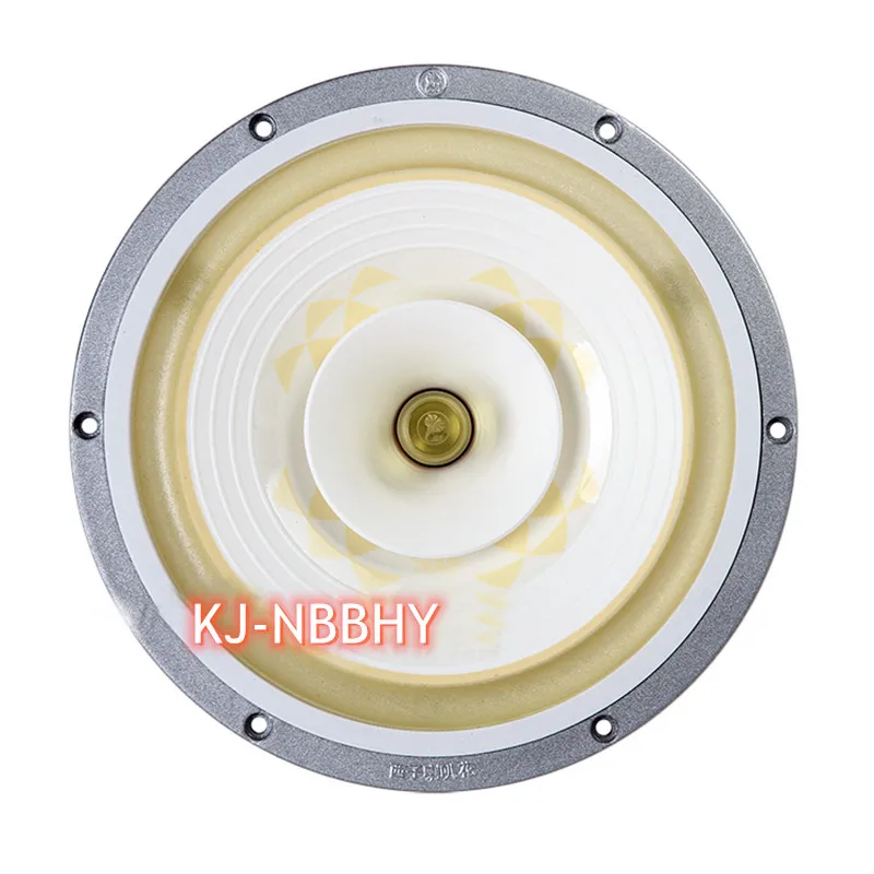

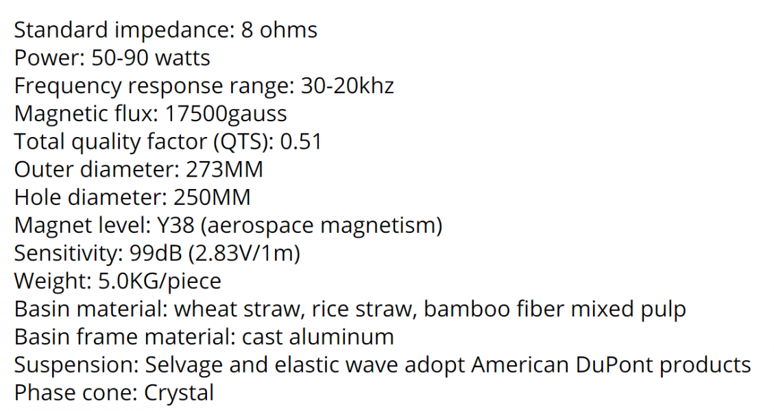

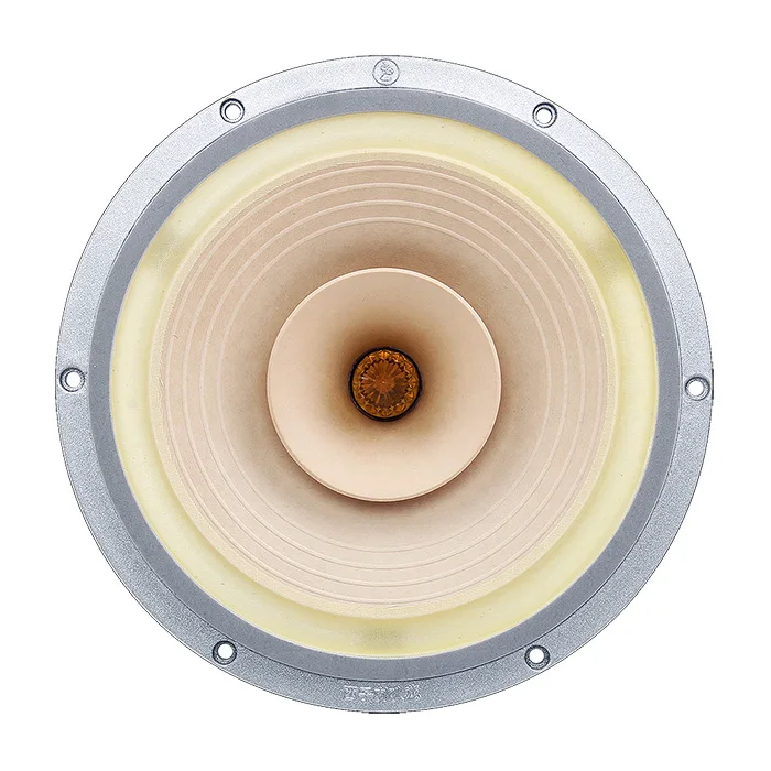

Aliexpress give 2 days' sale on several products.
Above 10 inch full range units have interesting specification at 700$ per pair including shipping.
They also have newer model at 800$ including shipping.

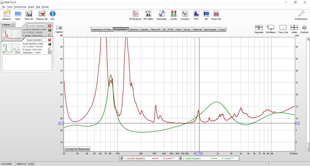

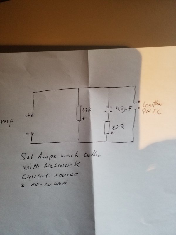

Another thing from Lowther, the Lowther pm 2c is an awesome midrange driver. to elicit a good bass and straight frequency response. If it has to be impedance matched, this filter prevents it from screaming from 3 kHz. the bass impedance peaks need to be smoothed out so that it produces good lows.
For a 15 ohm lowther

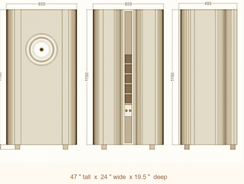

They also sell fully-assembled one at 3k$ shipped to your address.
Sensitivity: 100 dB
Impedance: 8 ohms
Driver: Crystal 10
Frequency Response: 32 ~ 20kHz
Dimensions: 47"H x 24"W x 19.5"D
Weight: 123 lbs. each
Power Requirement: as little as 2 watts
Crossover: None
Accessories: None required.
Cabinet: Rear Ported
