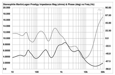

Here is my concern. Let's take your current Prodigys. As Dr Toole would say, there is better/more relevant information on the side of tires, than current audio specs.:) Lucky you we have independent measurements, not "specs":
As you can see, the impedance varies all over, worst being a HF where it drops to around 1ohm at 20k. That's not the issue per se, it's what is the impedance (and phase angles) at frequencies that do have significant more music content? If you read JAs comments, he alludes to just that. Luckily, your VTLs seem to have plenty power, even at 4 ohms.
However, as you can see in the power table, output has dropped significantly at 2 ohms, to around 50-60 watts at 3% THD+N.
I think for such an expensive purchase, it might be best for you to know all the relevant information. I'm not saying the VTLs won't work with the Neoliths, just that more info is better than less.
By all means consult with ML to see if they recommend adding a series resistance to the main panel.
