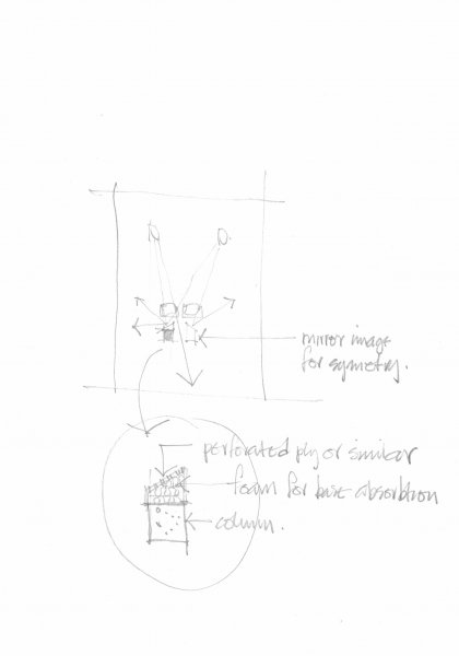

Ron - I would try and avoid any reflections off column or screen as they will be the worst in the room - similar to triangle proposal by cjf but would add a dummy to ensure symmetry and perhaps add bass and mid absorption as low frequency wont see the angle - similar to this sketch
diffusion will create phase issues so redirection or absorption are the go
cheers,
Phil
