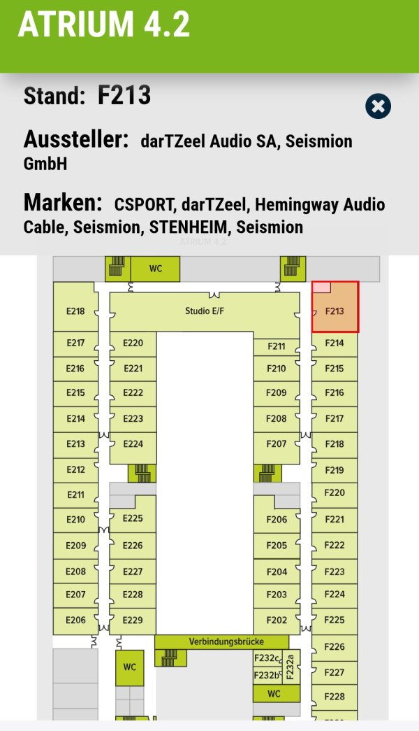

We are excited to announce that Seismion has its latest models of active vibration isolators on display at the following rooms:
- Atrium 4.2, F 213: as co-exhibitor with darTZeel
- Hall H 2, H 07 / J 11 as co-exhibitor with Extreme Audio
Beside that, also the New Reference turntable, a result of the cooperation between Thorens and Seismion, will be shown at the Thorens booth
H 3, M06/N05/M06N05
Our isolators are used under various equipment like turntables, DAC's, amplifier and even loudspeakers. We also present some premiers of new products, so please come over to experience what a difference high-quality vibration isolation can make.
We are looking forward to meet you there in person!
Screenshot_20240503_095116_HIGH END.jpgScreenshot_20240503_094857_HIGH END.jpg

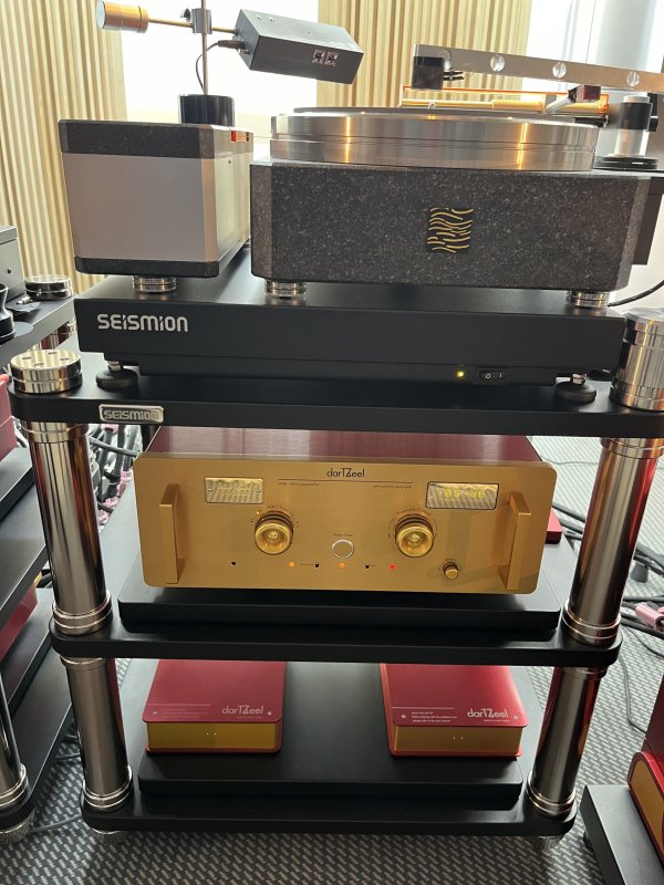

It was so nice to meet Marcus and Sebastian in the show. They brought over 15 isolators and were demonstrated in three rooms.
Major brands like darTZeel, Rockport speaker and Sigma Acoustics were using Seismion isolators. They didn’t get enough to satisfy the demand. The result was undeniable. They didn’t want to turn them off.IMG_3972.jpeg
Reactions: Mike Lavigne
Major brands like darTZeel, Rockport speaker and Sigma Acoustics were using Seismion isolators. They didn’t get enough to satisfy the demand. The result was undeniable. They didn’t want to turn them off.View attachment 131080
looks familiar. ;) I do know what active can do for the 468's, and the whole signal path to boot. never turn mine off either.
Reactions: TLi
Above photo also shows our new Audio Rack. It will be available in different finish, a gold version is being assembled right now. The whole production and polishing is done in house at Seismion. The rack includes some passive damping elements (see the lower two elements) and an especially solid mechanical construction, so that it forms the perfect base for our vibration isolators.
