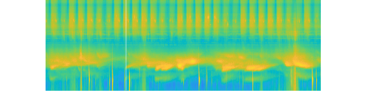

I can fully confirm what Mike Lavigne answered to this. In fact, most of the vibrations in building is actually below 4 Hz. The following diagram is a measurement straight out of our lab, which is located on the base floor and has a very solid foundation. We use such measurements to check the performance of the isolators, which are placed on a solid optical table.The figure shows the spectra of one sensor on a solid optical table (below the isolator), and another sensor on top of the isolator. Both in vertical and horizontal direction, which makes 4 signals in total. If we take the black curve (vertical spectrum (in µm/s) on the optical table) you can see the highest amplitude is around 2 Hz, and then decreasing. Additional to this shape, the horizontal sensor (magenta) shows a distinct resonance of the optical table around 18 Hz. Apart from this, the floor would also have the maximum amplitudes below 4 Hz.First of all, you should ask yourself what vibrates below 4 Hz in your house. The only thing that comes to mind is tectonic earth movements. I think when that happens, you have other problems and you don't listen to music. Joke.

In this graph you can already see the two sensors on top of the isolator (blue and red) have an increasing gap to the spectra of the ground. Already at 1 Hz there is more than -10 dB reduction in vertical direction, and reaching -40 dB in the audible range.
These vibrations are already on a low level, and due to the isolation, the sensor on the top-plate even reaches its noise floor around 20 Hz and above. (This is just the external sensors that we use for measuring it, not the internal sensors of the isolator). Somewhere higher in this thread I showed a measurement from Accurion, which claim they measure it with an amplitude of 100 µm/s, which is roughly 100 times larger amplitudes than we have in this measurement.
I have checked a few other publications about building vibrations. Here is a graph from the source "Seismic performance assessment of reinforced concrete structures with masonry infilled panels: the case of block #22 of the Santa Maria hospital in Lisbon, ISET, Proence et al, 2004."
You see in a multi-storey building the resonances around 2 Hz are even much more emphasized.
If you then use a passive isolator with a resonance of let's say 3 Hz, they even enlarge these peaks further.

Here you can see what's going on in Germany live seismograph.I can fully confirm what Mike Lavigne answered to this. In fact, most of the vibrations in building is actually below 4 Hz. The following diagram is a measurement straight out of our lab, which is located on the base floor and has a very solid foundation. We use such measurements to check the performance of the isolators, which are placed on a solid optical table.The figure shows the spectra of one sensor on a solid optical table (below the isolator), and another sensor on top of the isolator. Both in vertical and horizontal direction, which makes 4 signals in total. If we take the black curve (vertical spectrum (in µm/s) on the optical table) you can see the highest amplitude is around 2 Hz, and then decreasing. Additional to this shape, the horizontal sensor (magenta) shows a distinct resonance of the optical table around 18 Hz. Apart from this, the floor would also have the maximum amplitudes below 4 Hz.
