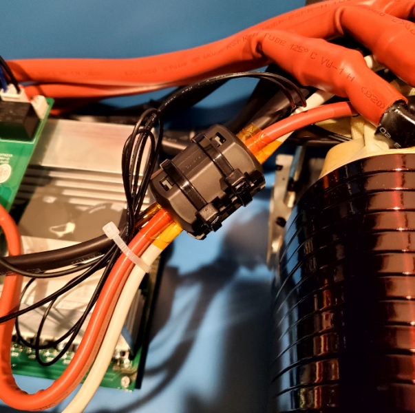

Sure. The sine wave inverter works by modulating a square wave as the carrier using a sine wave. That sine wave is often generated using rough samples in a table as the controller lacks the computing power to generate it on the fly. The square wave carrier will then need to be filtered and that is challenging to do well because of the high switching power.
A sine wave inverter can be thought of as a high power amplifier and with it, have a THD rating. I plan to do an in-depth analysis of them compared to mains power. For now, yes, you can do a good or crappy job of generating that sine wave. The response can also be load dependent with distortion levels varying depending on how much power you extract from it.
I just looked up the spec on Stromtank and it is rated at 2% THD which is the same as my lab grade AC supply.
One of the challenges of 3-state PWM inverters is RFI (this is mostly 1MHz and above--well outside audio range), so what I so is add these mix 31 ferrite chokes to wiring both inside and outside the inverter. Also all wiring going to PV panels if you're on solar like I am.
