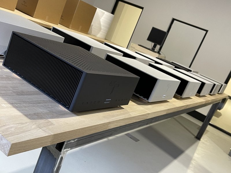

Before signing off for today I'd like to share a few photos of our brand new assembly space as long as it's still this clean and empty :)
I think I have found my new Zoom background. :)
Reactions: Taiko Audio
