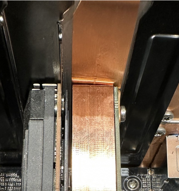

The network card has successfully completed an overnight test run at 100% load at 75 Celcius. We are considering the problem as being solved. This does require both a firmware fix to "tell" the processor it's a 85C part and an adjustment to the voltage monitor to allow for more variance in the supplied voltages which begins to deviate above 67C. Although this is in fact a "non operating" temperature for the Extreme's motherboard and we could simply ignore it there is a degree of manufacturer pride involved which wants it to be "perfect".
Now I did disclose earlier we made an interesting discovery with regards to sound quality in an earlier stage while we were experimenting with heatsinks. Heatsinks do not actually solve anything beyond a few degrees more headroom on the processor as the ambient temperature dominates the issue, maxing out at about a ~5C gain, but one particular design does actually improve sound quality. Because of the inconvenience caused by this problem and, well because it sounds better, and we know you all love heavy stuff (it's about 1 lbs), we have decided to supply this as a free upgrade. It will take us a few days to CNC machine these and then we will ship out replacements to everyone including the new firmware, which actually turned out to be tricky to perform remotely.
A few photos of the prototype:

This is very cool indeed. However, need to pay extra attention not to damage/knock off surrounding components (especially the tall electrolytic cap) during installation as it's a heavy heatsink. Don't forget about ESD.
If I understand Emile's posts correctly, this is not a user-installed heatsink. New cards will be shipped with heatsinks and updated network chip firmware with correct temperature protect setpoint. The old (new) NICs will be returned to Taiko.

Seems like the bracket is part of the heat sink too! Nice.
I enlarged the pictures from Emile and the middle picture of the first set of heatsink photos shows that the bracket is independent of the new heatsink:
