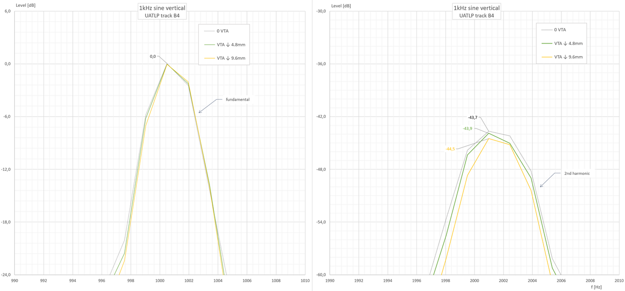

- A vertically cut 1kHz sine to check differences in waveform and harmonics due to changed VTA.
- A laterally cut 60Hz + 4kHz sine ratio 4:1 to check differences in ratio and side lobes due to changed SRA.
1kHz sine vertical, UATLP track B4. Measured with 0 VTA, -4.8mm VTA and +4.8mm VTA
FFT:
Closeup of FFT at fundamental and 2nd harmonic:
Waveform:

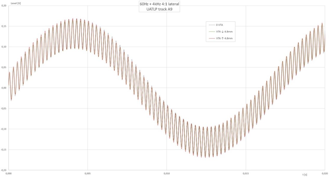

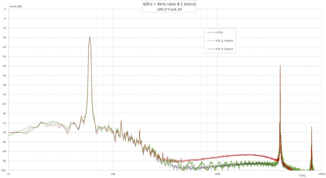

60Hz + 4kHz sine lateral ratio 4:1, UATLP track A9. Measured with 0 VTA, -4.8mm VTA and +4.8mm VTA
Waveform:
Closeup of waveform:

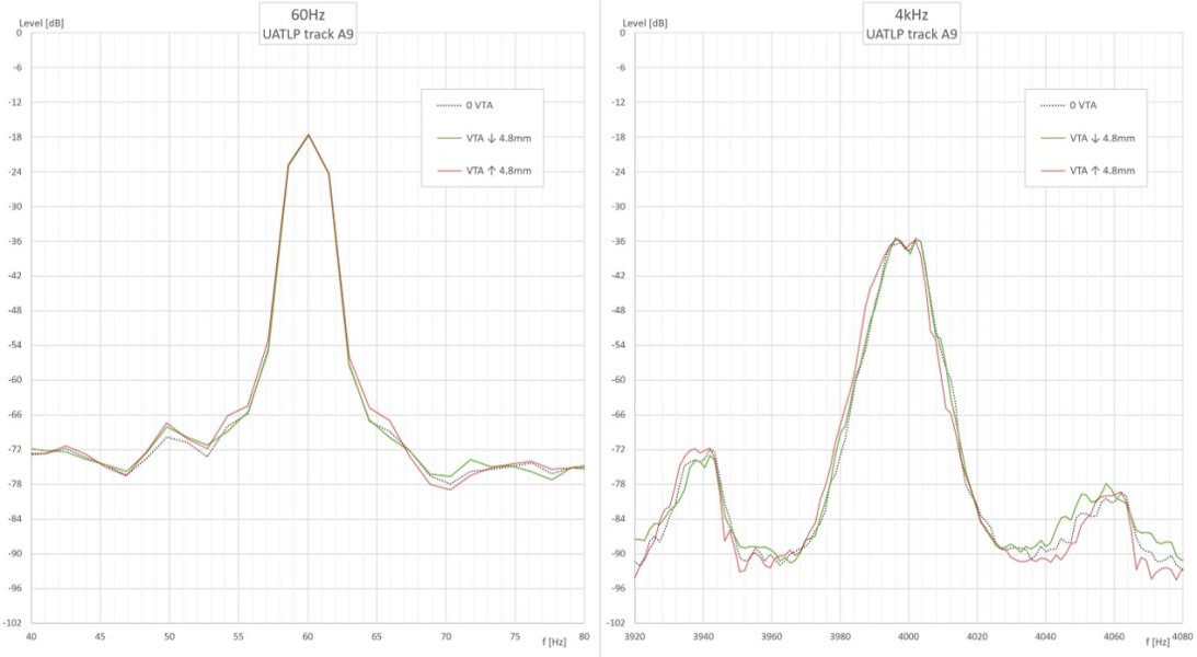

FFT:
Closeup of FFT at 60Hz and 4kHz:
If anyone has something different to show I would much appreciate it and I will be more than happy to change my opinion.
I really tried to find a change.
There's tons to read about VTA/SRA, but it is very difficult to find concrete results really showing the phenomenon of changed VTA/SRA.
Notes:
- "0 VTA" represent visually set tonearm parallel to 180g record.
- UATLP = Analogue Productions Ultimate Analogue Test LP AAPT 1
- Tonearm: Kuzma 4Point (one turn = 0.8mm)
- Cartridges: Audio-technica AT44GPT/II (VTF=2.02g) and Lyra Atlas Lambda (VTF=1.72g)
- VTF was set for "0 VTA" and not changed for each change of VTA.
- Recorded with a chain of Pass XP25 (160ohm/100pF) + 19dB OP-amp gain + HP-filter (-3dB @60Hz) + Tascam DR-40X pcm 24/96.
- Zenith error was <15µs for a 10kHz lateral sine and azimut was adjusted to give less than 30dB crosstalk @1kHz for the cartridges.

I suggest you review the many studies that were published in the 1960s through 1980s on the subject. You will see that they conclude differently but none of them, as far as I remember, used tonearm height as a means with which to impact VTA. It’s just the wrong thing to do as you are introducing too many changes in multiple vector forces which will certainly impact the data due to its multivariate nature (when changing tonearm height).
Further, the distortion characteristics for VTA increase at the inner area of the record, so you might try that out if you haven’t already. Use only vertically modulated track, of course. Horizontal modulation won’t show you a thing about VTA impact.
I can certainly tell you that, say, 3° of angular change at the head shell is very clearly audible even to an untrained listener. Of course, we controlled for the addition of the material in this testing by first listening to the same shim material at 0° VTA correction.
By the way, the sound of changing VTA/SRA in isolation doesn’t create any tonal changes easily noticeable. It’s just an improvement in clarity, image, separation, soundstage size, bass solidity and transient attack. Chances are that your cartridge needs plenty of downward adjustment. I own an atlas myself and have analyzed well over 50 of them. In most cases I can’t get them down as far as I would like them before the body starts getting too close to the record I regularly bring them within a half a millimeter from the record surface under stylus drag. Just shim it and listen for yourself. Keep that tonearm level.
By the way, the comment above isn’t a slam Lyra. They are absolutely fantastic, but they have the same problem almost every other cartridge manufacturer does: VTA is too high.
I did.
I totally see your point, but it is not too difficult to bear those in mind I think.
I uploaded a sketch just to show the impact of VTF here a few years ago (copy below).
If VTA/SRA is so sensitive, it really should show in at least some of the tests. How unlikely is it to have parameters sensitive to everything but not showing anything?
I know that VTA is an angle defined at the cartridge, but 1° at the cartridge is the same as 1° at the tonearm pivot. The difference is that the forces change. That's why I wrote to adjust VTF after VTA/SRA adjustment.
Still, those are the means I have to change VTA/SRA if I want to keep especially zenith and do measurements in a controlled way.
Your point is valid, but nevertheless, a VTA/SRA change by +/-5mm at tonearm pivot doesn’t impact waveform or FFT, at least not for a line contact stylus.
Sorry if I seem stupid stubborn, but if I’m wrong or correct in the statement above, A LOT of discussions in this topic would be clarified.
I claim that VTA and SRA are NOT as sensitive on a degree for degree basis as zenith error correction and azimuth. I see no reason why it cannot be measured. It certainly has been in published studies.

My intention was that UATLP track B4 is for VTA adjustment and track A9 is for SRA.
If VTA is not sensitive for the current cartridge, SRA can dictate the adjustment and vice versa.
I have the same experience, especially with Lyra which I am very familiar with. By ear I always ended up with a smaller VTA than a level tonearm gives.
But if I can’t see it on the waveform or FFT, how can I see it?
Most of what I found deal with VMA and the problem of deviations in manufacturing, or it involves only one measurement not a variation of VTA/SRA. Also, it was not line contact styli.
James White and Arthur Gust did tests on different carts and varied VTA.
I don't have those papers anymore, but they varied VTA by 3° and showed changes in the range of 1dB for a vertical cut 1kHz sine. We can't use an adjustment method based on such insestitive results.
However, they got a 5dB change with a vertically cut 1kHz square wave by changing the VTA by 3°.
The audio-technica AT33PTG/II has a VTA=23° (mean value stated by a-t).
The vertical cut square wave I have (CBS STR-112) is cut with 15°, so I should get the best result by lowering VTA by 8°. I don't think that will work.
But I found some hope after a nights sleep (it's morning now in Europe). If I zoom into the FFT 2nd harmonic for track B4, there actually is a 1.6dB difference:
If I use the current "6 turns CW" (the green curve) as "0 VTA" and lower the whole tonearm by some 10mm, it may show correlation. I.e. it may be that I was too far from "correct VTA/SRA" in the above measurements and that the distorsion level differences sort of flattens out. Maybe.
I moved the tonearm down by 5mm and did the same 3-measurement procedure (0 turns, 6 turns CW and 6 turns CCW).
I named the "0 VTA" as still being when the tonearm is level.
It actually shows convergence.
If I lower VTA by 9.6mm compared to a level tonearm, the distorsion will be at minimum. For that change, the tonearm angle will be about 2°, which is quite logic since the VTA=23° for the AT33PTG/II cartridge.
So, by doing a 3-measurement procedure with a 1kHz vertical cut track, make an FFT and study the 2nd harmonic, it seems we will be guided in what direction and how much the cartridge should be angled.
