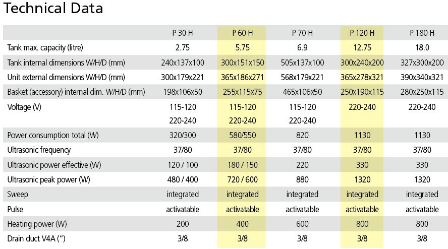

Neil, I wanted to double check the USC power parameter before I damage anything
Here is a convenient chart for comparison of the Elmasonic P-series:
Contrary chart, the P120H is supported at 115-120 V.
Elma now has a new 'S' series that is very similar to the P series but in three main respects, the S series does not offer dual frequency operation, S has 4 ultrasonic transducers compared to the P's 6, and S can be had for almost half the cost of P. David and I use an S120H tank for rinsing.
Tim @tima (and Neil @Neil.Antin ), would you still recommend running the P120H at 70% power? Is that enough or too much?
