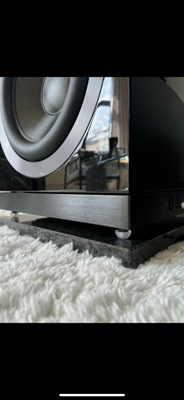

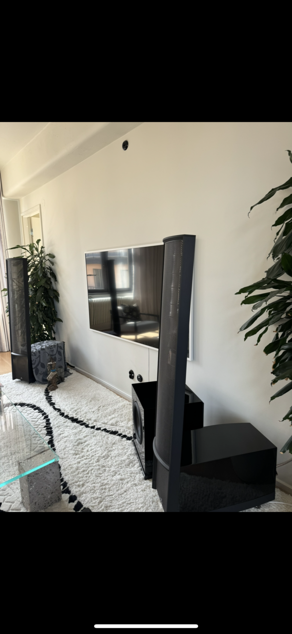

As for Subwoofer(s) I have lately been looking at different options. Something that blends in front row in my living room which I also share with my wife and my German Shepard. I went to audit the Bowers & Wilkins DB1D and was very pleased with what this "little" Subwoofer can do. I say little because it is quite slim for hosting two 12 inch drivers. The DB1D host 2 active 12inch carbon drivers working back-to-back (opposed) . Implantation was done in 5 minutes. First it localizes it self in my room, calibrating it self via microphone, in order to cancel out unwanted frequencies that does not land well in my particular room. Second, the two active drivers cancel out cabinet resonances, ensuring that all power is used to create bass, not wasted vibrations (my Martin Logans bass drivers works the same way and this seem to be a proven way to ensure great results). Third, I trust the 2000 watt Class-D amplifier inside from well proven Hypex. Proportions make it an almost perfect cube of ca 17 inches per side. Finish is IMHO as perfect as a Subwoofer in this price range can be. As it comes with a hefty weight of 43kg and the amplifier is located in the bottom of the Sub, pointing toward the ground (and actually building some heat), I invested in a one Inch thick Black Angola granite stone (to be seen in one of the pictures). The stone serves not only as a stable foundation, it also lift up the subwoofer somewhat from the carpet, preventing any heat to reach the carpet. Most important the DB1D sound wise blends seamless with my ML´s. I feel (and hear) that the sound stage is much improved in all directions. I am connecting it via a (one) subwoofer cable from AQ, direct from my Line stage, the simple but elegant Greyhound subwoofer cable. I am very intrigued to go for a second DB1D, not only for the musical upgrade this could mean, but also for the visuals. To seek balance is pleasant. There is a certain beauty in having a 12 inch carbon driver facing you, and I assume doubling up, would be even more delightful.
Some more pics…
