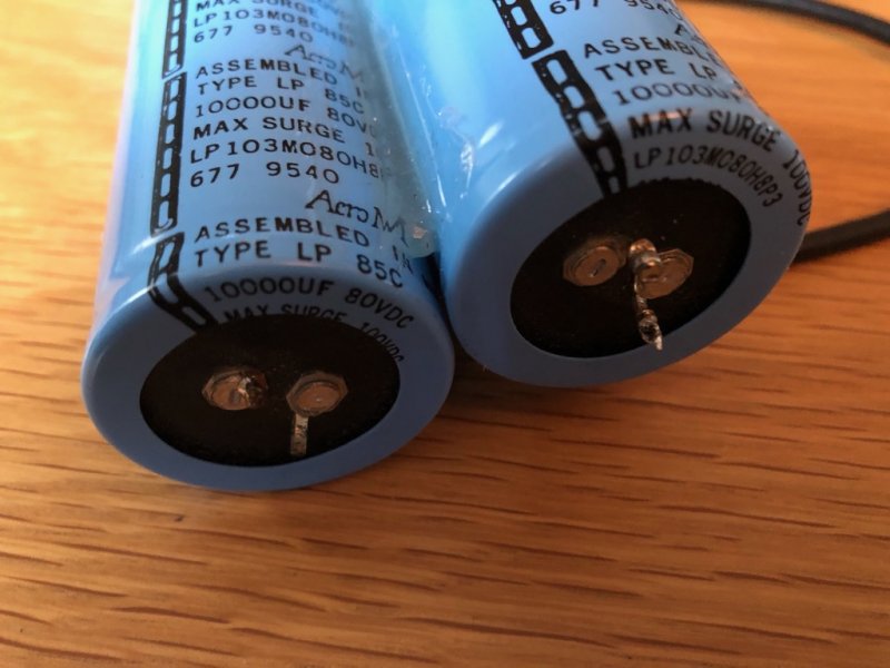

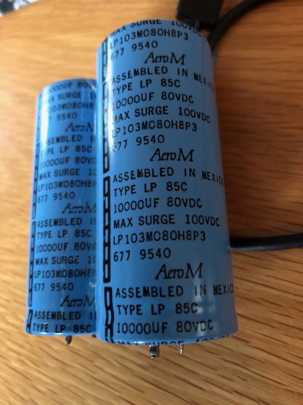

I found the caps that was replaced in the amp for my Genesis V. Probably the same is used in the Genesis II.
They are 10000uF / 80volt. The size is 35 x 80mm. They are snap-in 10mm type.

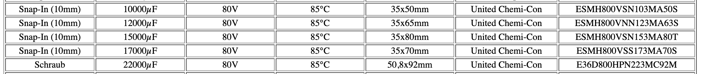

Modern caps are smaller and within the same size you can find caps with 15000uF or 17000uF capacity. I guess a bigger powerbank is better, but hope than someone with better technical skills than me can confirm this. @garylkoh
I did a search on the net and found lots of caps in Europe and USA, and of course from China. I am not sure if a will rely on a Chinese supplier the next time I need caps.
Attached you will find two pictures of the old caps from my Genesis V and a part of a spreadsheet I found in the bottom of this Ebay-add.
