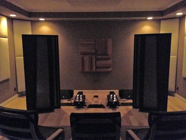

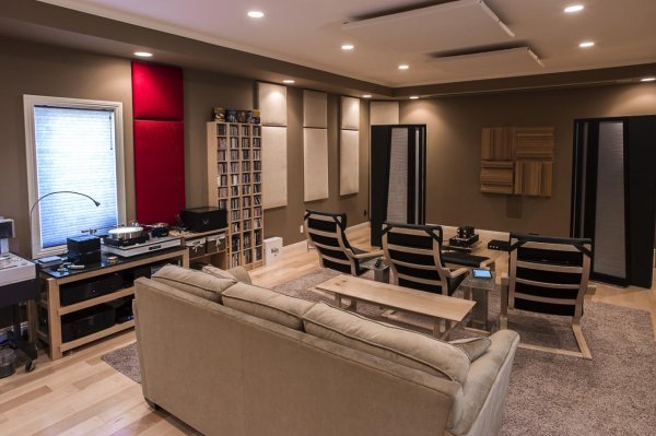

OMG!! - Kip has his FRs with Micro Seiki 5000 and a Studer.
That looks like a Thomas Schick arm at the back! The other arm is a FR64S?
BTW, very nice system setup :)
I could cope with that little setup, though the speaker covers would go straight down to the local car paint shop pretty quickly.
That sorted, then very, very nice.
