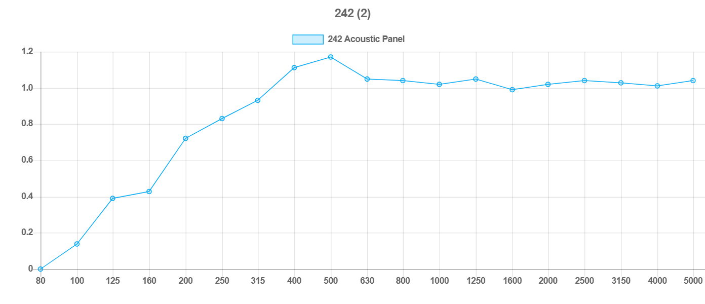

Nb. GIKs are 242, I think they tame higher frequencies and reduce decay time too.
Cheers
Thanks Barry - what you heard does sound like a speaker positioning issue - If they they are forward pointing moving closer together as you say should pull the image together - I think peoples preference for toe in depends on the on axis HF output - if you like a declining fr ( as toole geddes linkwitz et all postulated ) - with quite a few speakers this means listening off axis is the best - of course just a theory
This is the GIK performance - excellent above 400Hz and what that means is you will get increasing levels of reflected sound below that level - the theory is that bass is non directional below about 170 Hz so this reflected sound between 170 and 400 does not correlate with direct sound and crates smearing .
But of course it may not be that significant in practice in this room 1627945621811.png
It will be very interesting to see how the experiments go
