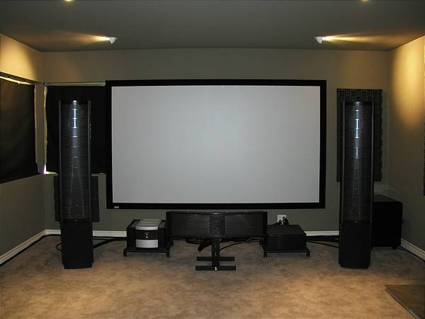

I find my Summits Xs to play full body music as well as life like transparency and imaging to die for. It’s very important for speaker placement and to treat your listening room properly for the stats to sound their best. As you can see in the photo below of my system I have the wall behind the speakers treated very well. Also having Class A amps is a big plus for the Summit Xs. Stats sound better the more power you give them!
Beautiful set up George!
Best,
Adrian Low
Thanks Adrian! Nothing like just relaxing and listening to your music and not the equipment. :)
i agree!
beautiful artwork to delve into whilst indulging in some luxury listening.
does the heat off those amps affect the paint in any way?
i agree!
Thanks! Not at all. The canvas artwork is printed on via a very large inkjet type printer.
