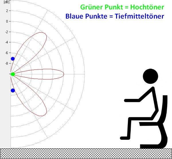

no. if you have read what I have described you know. if the distance between the midrange speakers is too large you will get a frequency response like the course of a stock exchange price (valley and peaks).
In a “real” D’Appolito arrangement, the distance between the two membrane centers of the midrange drivers must not be greater than two-thirds of the wavelength of the crossover frequency of the midrange and tweeter. Then it works perfect.

This only happens if you sit too close to the speaker and your ear height is much lower or much higher than the tweeter. This causes sharp dips in the frequency response. This is why horizontal d'Appolito center speakers don't work well at all because the radiation behavior in the vertical plane is poor.
