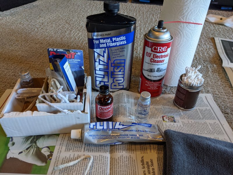

That’s some hard work. I will need to work up the will to start and finish over a weekend.
It's a labor of love. I listened to CDs while working on it. The hardest part is disconnecting everything, removing from stand, putting back on stand, and reconnecting everything (and praying that it works). The cleaning is not hard, just tedious and of course time consuming.
Who makes the tube dampers or covers on your tubes in the first pic? They look like they do some cooling. How often do you clean the tube pins? Thanks for sharing.
The tube dampers were made by Andy at Vintage Tube Services. I got them at least 15 years ago. I don’t think he makes them any more. They work very well. One time when I shipped the Io back for some tweaks, I accidentally left the tubes and dampers in. It arrived with glass shards in the phono stage. Silly me.
I do the cleaning twice a year. It is a revelation every time I do it. Velvety black background and super smooth high frequencies.

This is the most beneficial thing you can do to get top performance. Big job. With COVID I will be doing it again.
I use other methods I have developed over the years to get similar results and hopefully make it less work.

I took a couple hours this afternoon to clean the Io connectors, tube pins and tube sockets. Here are some photos.
Phono stage with top off:
