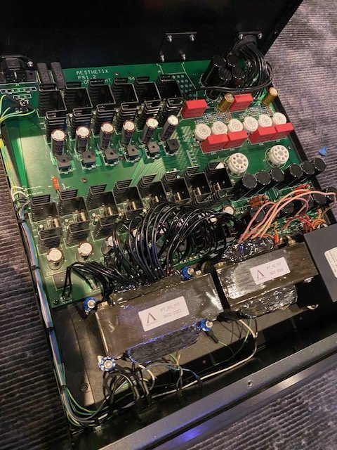

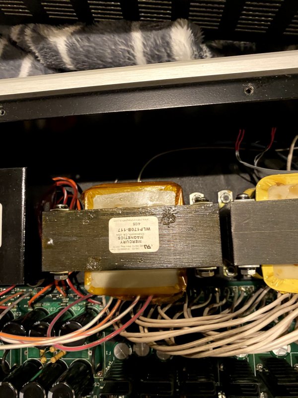

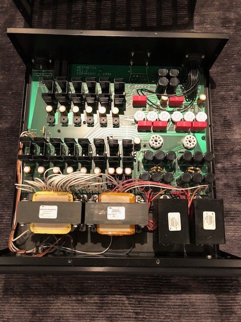

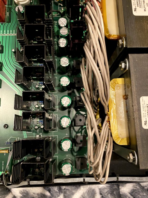

So, I opened up one of my power supplies to check out the power supply tubes as I was getting ready to make some tube orders. The power supplies in this one power supply seem to be of the older variant and not the new ones. At least I don’t see or can’t tell if anything has changed. I have a few of the original power supply pics and these look the same to me. This is what I received back from Aesthetix. I will check the second power supply tomorrow to see if that has similar power supplies or something different. I was told I was getting the new power supplies when I made the order to upgrade to partial Eclipse with dual power supplies.
New power supply
View attachment 142660View attachment 142661View attachment 142662View attachment 142663View attachment 142664View attachment 142665View attachment 1426660xcQdpeLQ_uFVoU_y_iCxQ.jpegKn7UIyy2TgWk_G61YgpHjw.jpegnrrQI1bSSguBZoiexkfBjQ.jpeguRfRlZzuTeeaM9cD98YQMg.jpegA9eeS_pvTrmjPMt2aXZMJA.jpeg
New power supply

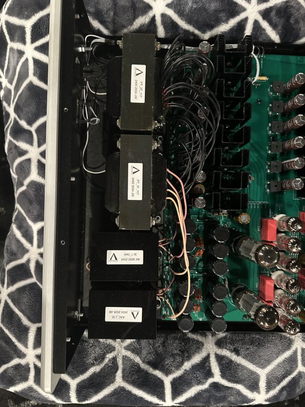

@audioquest4life your links don't seem to work for me. The first pic is the old transformers with the varnished coloured core. The second pic is the new transformers that are primarily black. Capacitor changes in the PS and control unit were part of my mod to the new transformers. In the control unit the coupling caps that are gold colour were part of the partial Eclipse mod-- the gold caps are stealth caps and are the primary part of the partial Eclipse mod.

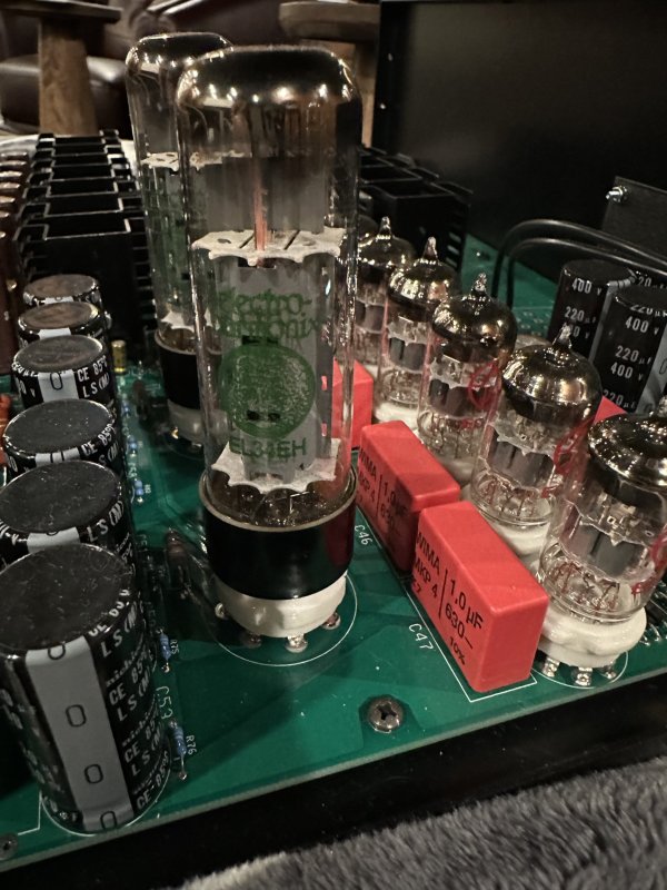

Tubes in power supplies? My two power supplies have two different sets of 12AX7 tubes. My older power supply has Tung Sol 12AX7 and the newer power supply that I added has JJ 12AX7 tubes. Being that there are six in each power supply, would having different sets of tubes in each power supply negatively affect the sound qualities of the music? I am thinking maybe not as the tubes in the power supplies are not signal related, only part of the voltage rectification circuits. Anyone know otherwise? I do plan on matching the tubes as I don’t want to have any tube mismatches in any of the circuits, power or signal. Maybe I am a little OCD about matching tubes.
The 12AX7s are in the voltage regulation, not the rectification. Nit pic aside, the critical aspect is low noise and low microphony. The quieter, the better. I often run tubes in the phono stage for a couple years, then move them to the power supply.
Currently, my power supplies use low noise matched Telefunkens. They were in the phono section for a couple years. It is super quiet.
While the matching is not as critical in the power supply, you can match tubes in the first position in the left and right supply, then in second position in the left and right supply, etc.
As long as the tube rush noise level is the same in both channels and gain is well matched, then your current tube selection and position should be fine.

These are the original transformers, not the new Aesthetix in house ones.
Here are the new ones. The older ones had the caps upgraded to bring it up to date, somewhat.
