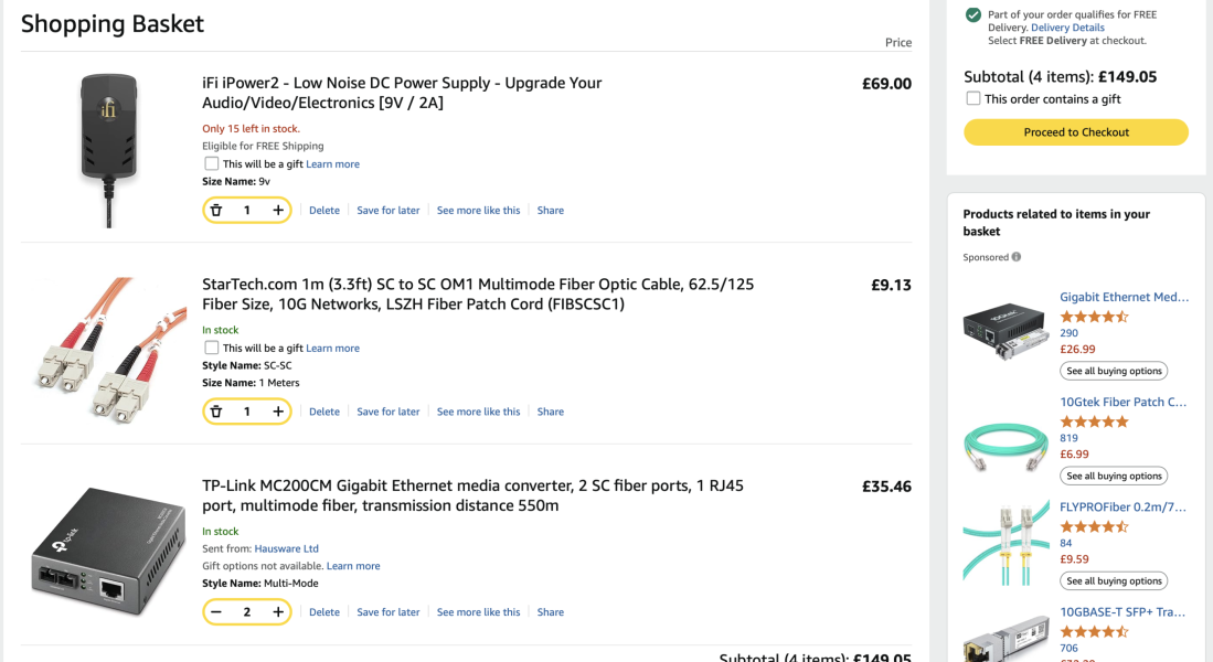

The problem is that "noise" coming down wire into your streamer/DAC can affect sound quality. The most likely candidates are EMF from switches and RFI from wireless transmitters. You can also get 50/60Hz harmonics from nearby power cables. Fibre completely eliminates these problems. It conducts electricity as much as a banana or a stick of spaghetti. The benefits of a fibre bridge have been appreciated for at least 10 years.
You can go for this for about $200 or System Optique for $3,000. There's a UK company that does one for £6,200, about $8,000.
This
