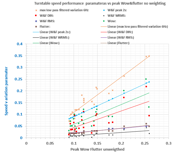

0.2% 2Sigma wow can be very different from DIN weighted W&F. .
O.2 DIN is not good and easily audible on piano. A test tone with DIN 0.2 sounds very shaky. I will post a comparison of different WF number formats soon..

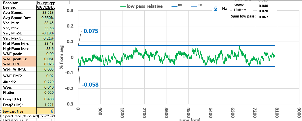

Depending on TT and record I get 0.045 to 0.07 with the AM WF calculation
Here are different W&F numbers compared against peak wow in test. This is based on Shaknspin tests, and omits effects of test record eccentricity. I find the DIN values suspiciously low ... but that is what the device gives. AM 30sec calulation will give hiogher numbers since som drift will be detected over 30 sec period.
The plot shows that a DIN W&F of 0.1% actually can have peak wow of 0.25% but it may be filtered out.. of all the turntables measured here(26) the highest filtered DIN W&F is 0.22% and 3 are between 0.1 and 0.2 DIN, the rest below 0.1%DIN. All are belt drive except for one DD
Does anyone wonder why Japanese TT use W&F WRMS for their spec?, it gives the lowest number...
This is a very good result, but still audible on a test tone

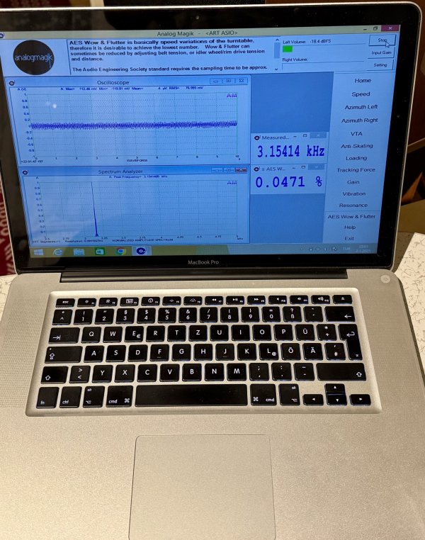

AM conforms to the AES standard, AES 2008, if I’m not mistaken. IMHO, it’s a more complex test that detects speed deviations better, which is why it shows worse results compared to other simpler alternatives.
Good wow-and-flutter (w&f) performance is certainly audible and has a noticeable effect on the final sound. IME, any turntable with w&f equal to or under 0.06% using AM software and the AM test record is a great performer. With a better test record, it can go even lower, but for the sake of consistency, I use the AM test record. BTW, it’s better than the AP test record in terms of w&f.

Here is a w&f measurement with AM V1 disc. It could have been a little better if I gave it a 30min warm up time. Frequency is not precisely 3150Hz cause I didn’t adjust it either.
