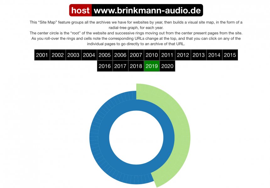

While I am waiting for the delivery of the Ront III, I searched the Internet archives , for the Ront evolution from the first generation to the current
I used the ‘WayBack Machine ‘ and had the chance to visit Brinkmann’s site and notes as early as of 2001.

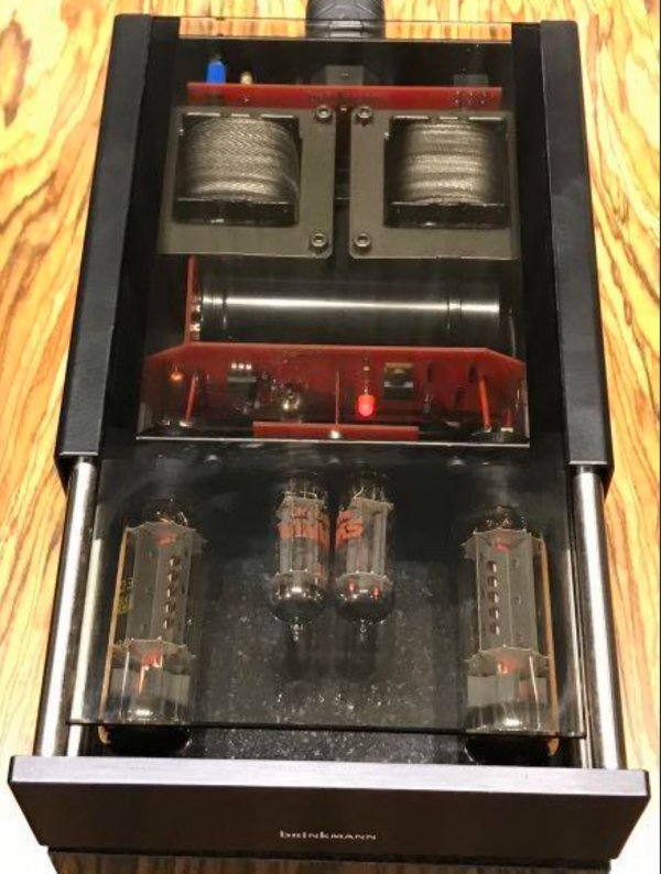

Ront first generation was using 2x EC360, 2x 6Bw4 and one 6111w soldered on the circuit
With the introduction of Sinus motors, the need of increased current to feed them, led to the redesign of Ront in a Class A single ended topology, which among others offered a further improvement in terms of smoothness and transparency.
The tube supply utilized two high current low resistance pentodes (PL36) and one full wave rectifier (5AR4). All tubes intended for long life. Secondary AC voltage is rectified by the full wave rectifier and fed to both of the output pentodes via a line choke reducing even more mains noise. The output voltage is stabilized by controlling the output pentode stage

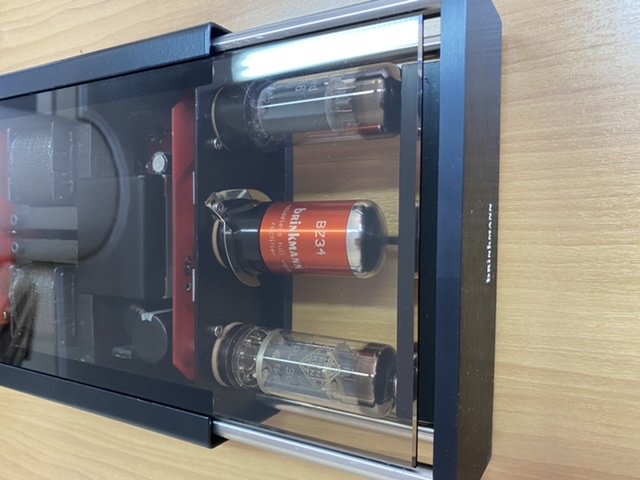

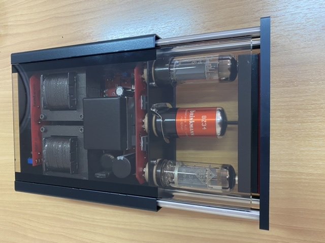

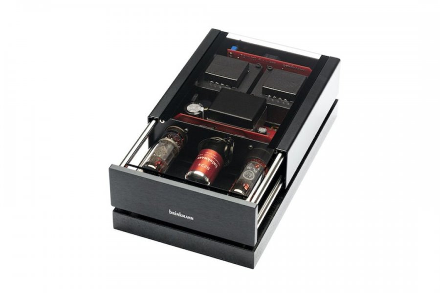

Ront III introduced some weeks ago.
As per Brinkmann, the need to do so was triggered by the quality inconsistency of the today production vacuum tubes and the rarity of quality NOS tubes. Therefore for Helmut and Matthias, the design and production of their tube, was the logical thing to get over the problem
Brinkmann BZ34 (which has unlimited lifespan and flawless reliability), through its complex circuit, emulates the function and sound of the GZ34 NOS Mullard tube, without its downsides of wear and failure. It can also be installed to Ront II power supplies.
Besides the introduction of BZ34, Brinkmann has made some circuit modifications, he has re-designed the high voltage path and has upgraded the transformers.

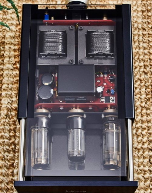

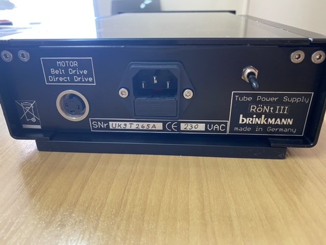

Ront III has just been delivered to my office.
Shortly I will compare it with my Ront II and will revert with videos, measurements and sound experience.
0D2AF8FA-AEA5-471C-83DF-D8FA4E0B8EE0.jpeg65B53523-3CB3-4DF5-B037-58F294B23E20.jpeg1A809D73-2A43-426A-AAE0-D615DBC96B24.jpeg
You always get the cool toys Savvas ! :)
I can’t help but be fascinated, happy to be a part of your journey, and eager to hear your impressions Vienna as this newest RöNt III settles into its new home in your kit. Of course, I’m simply delighted in your most recent acquisition. Congrats sir!
Reactions: Vienna
Thank you so much, I really appreciate this
Reactions: DetroitVinylRob

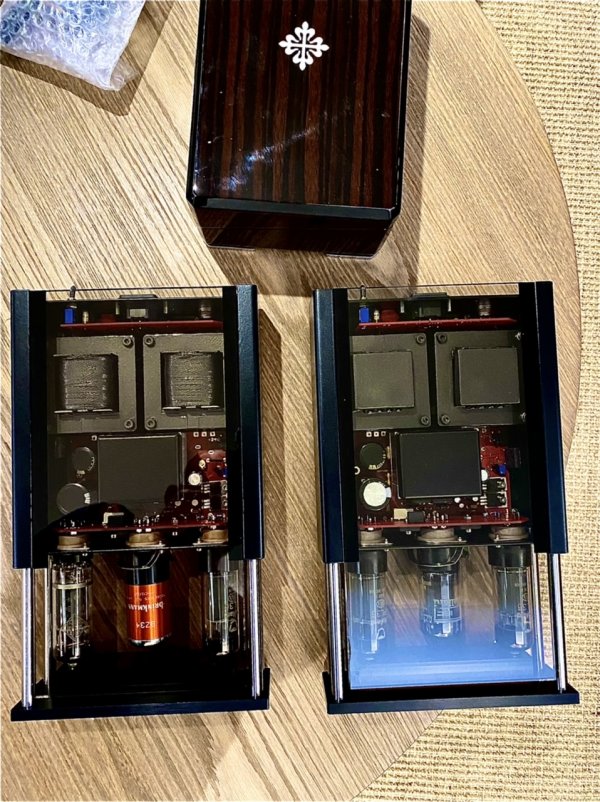

Ront II and Ront III side by side. Obviously there are, some differences on the circuits and components

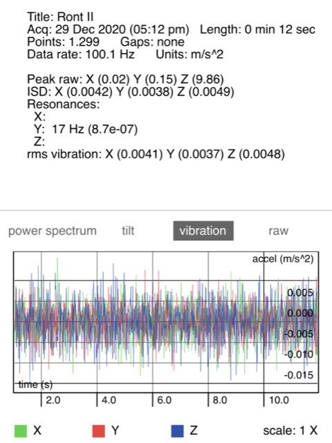

Since the kids were attending some e-classes yesterday, I could only install Ront III and take some measurements.
What I noticed from the beginning is that Ront III is totally silent, I mean dead quite. With Ront II, with my ear next to the power supply I could hear a slight buzzing which was further slightly increasing with the motor running.
My vibration measurements by placing the iphone on top, on both Ront versions, verified my observation. In addition a resonance measured at 17 Hz at Ront II, is no more present at Ront III.
Ront II measurements :
Ront III measurements:
Measuring the performance of Brinkmann Balance, with Ront III powering the controller and motor its again evident that wow/flutter is slightly reduced and measured at 0.45% , while the speed is much more stable.
I am curious to see how much, these improvements, will affect the sound
