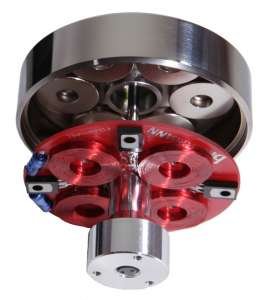

Reading Brinkmann notes on Sinus motor (https://www.brinkmann-audio.de/main.php?prod=sinus&lang=en) : QUOTE....For over two decades we relied on the well-regarded German manufacturer Papst to supply capstan motors for our belt drive turntables. ...UNQUOTE
Well, I had to pay over 4,000 euro and a month of back and a forths, in order to discover the reason for which, Brinkmann is not anymore using PAPST motors.
In comparison Brinkmann Sinus (with the 500grams flywheel) is the king in silent, vibration free, resonance free and all-analogue smooth operation (this is reflected through measurements and listening). I should have paid more attention to Brinkmann’s white paper.
(photo from Brinkmann site)View attachment 71831

The flywheel makes operation super smooth and absorbs any micro-variations from pulsation of motor poles. I have a 220 V version of the Pabst capstan motor used in the AS 2000 and TechDas Zero TT's, it is good without a flywheel, but i prefer the sound of the Studer A 80 motor with a 5 kg integrated flywheel that i also own. Im sure that with a large flywheel the way David and TechDas uses it, it is much better. But the Studer Pabst motor is not a quiet motor, it has bearing noise, but is far from my listening position, i can not hear it when listening to music, but just knowing it makes noise would drive you crazy Savvas !;)

My friend it’s not only the audible noise of Papst motors or the lack of flywheel, there are resonances too, measured from 38 to 48 Hz, also the measured vibrations levels are almost double comparing with the Brinkmann Sinus which doesn’t produce any audible sound and resonance

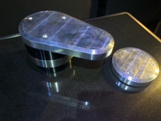

Agreed, I love the product, however the arm boards are incredibly expensive.
I made my own , I respect that everyone wants their pound of flesh- but in this case- far too much. These are just off the CNC machine and will go for finishing and anodizing shortly.

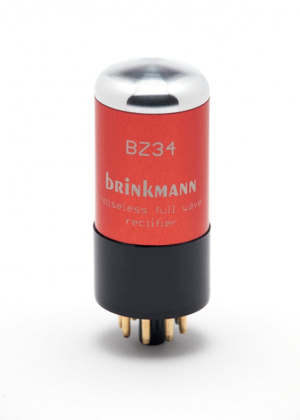

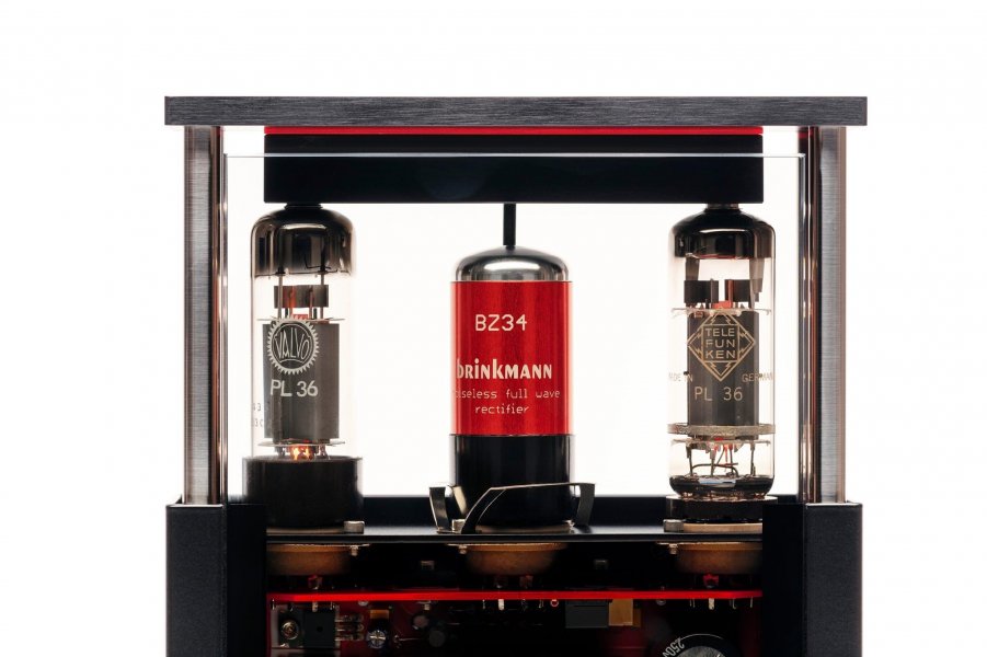

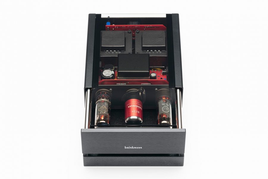

I have just read that Brinkmann has just launched Ront III.
their announcement :...We proudly announce RöNt III: the third generation of Tubed Power Supply for use with all Brinkmann turntables. This product debuts our proprietary “Rectifier Tube Simulator” to combine higher performance with lifetime reliability...
Brinkmann states that the new rectifier BZ34 can be installed to Ront II power supplies and that ....Aside from the BZ34, RöNt III incorporates additional circuit modifications including a redesigned high-voltage path for increased transparency, more palpable and dimensional sound, as well as more musical detail and “Flow.” RöNt III also benefits from upgraded transformers...
View attachment 72308View attachment 72309

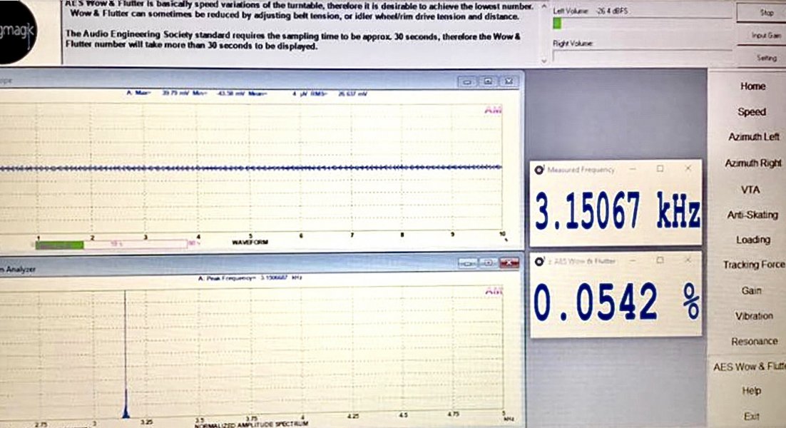

@Kcin , i am strongly suggesting you to get EPDM calibrated belt for your Balance.
By doing so, I am experiencing much higher speed accuracy and improved lower wow/flutter.
With the original belt the measured wow/flutter was 0.0622% (https://www.whatsbestforum.com/threads/brinkmann-balance-kuzma-4p.31089/#post-663940), with the EPDM belt, the measured wow/flutter (with Analogue Magik) is 0.0542, much better than many direct drives.
P.S. Unthinkable performance of the super silent Brinkmann motor, power supply and bearing, especially when you will consider that Helmut is using an all analogue controller and no speed feed back and of course no hall sensors
